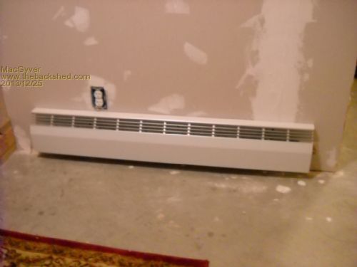

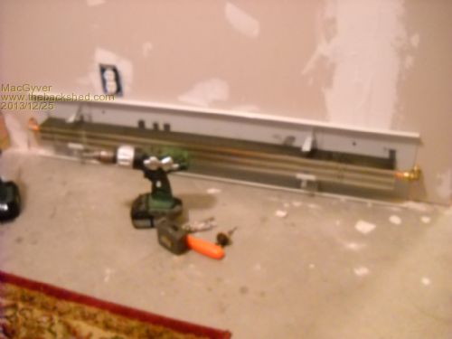

This is the "before" shot showing initial installation. All pipes are
insulated within the walls and attic with closed-cell foam insulation.
Voila'! This is the finished product mounted on an as-yet unpainted
wall. It works like a champ!

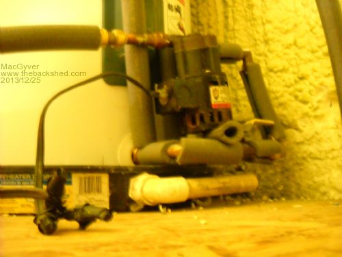

Here's that little pump. It's on a timer and cuts off a half hour before
my free-electriity window ends. That gives the water heater time enough
to recover and I get a free hot shower when I get up iin the morning.
