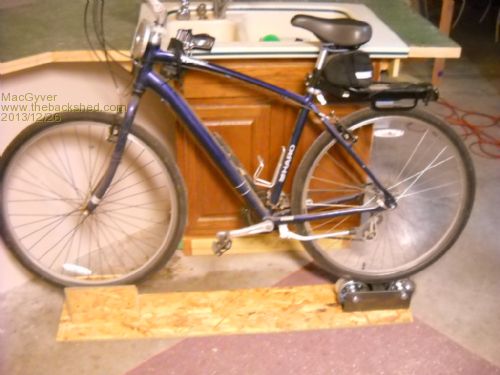

My Christmas Day project was to assemble a stationary bicycle stand, such that I need not disassemble my bicycle to use it. Winters here (Texas) are on the brutal side and often times there is too much ice or snow on the roads or it's just too darned cold to go for a ride, so a riding bicycle platform will more likely get my lazy butt off the couch.

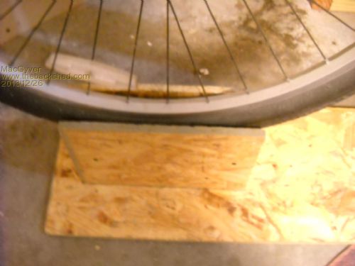

Basically, it is a board with a mechanism at the rear, which allows the drive wheel
to move without going anywhere and a "slot" up front to hold the front tire in one place.
This is up front to capture the bicycle's front wheel and keep it in one spot.

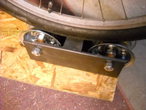

The rear wheel of the bicyce is cradled between the two free-wheeling wheelbarrow hubs and away we go. The rear thingy is a piece of 4" mild steel welded tubing. I cut out two "U" shaped slots and attached two metal hubs taken from wheelbarrow wheels. They were $10 each with the tubes and tires; anybody need tubes and tires? Me neither.
Secondarily, it was my intention to attach a suitable pulley to the aft hub and then attach a small generator. That was until I started to think it through!
The ratio between the rear wheel size and the rear hub size is 8:1. That means, for every turn of the rear bicycle wheel, the little hub turns around 8 times. At 60 rpm (that's one turn each second), it translates to 480 (60 x 8) rpm at the little hub and that's NO LOAD!
That in and of itself is a pretty good workout for 65-year-old legs, not to mention the smallest alternator I have cuts in at 450 to 480 rpm!! Can you imagine the puddles of sweat just to keep the thing charging at all?

Try one of the old type generator units used to power lights on bikes before decent battery head light combos came about, the name of them escapes me right now.
Increase the size of the wheel that sits against the bike tyre and it should make for easier pedalling. You won't get much power out of it but even Armstrong was only good for 250 watts for a short time, the average rider is good for 100-125 for a short time.

Wouldn't you know it? I was pedaling away, minding my own business, when the rear wheel jumped the tracks and I went hurtling across the room and hit the wall!
And you gotta know that big black mark on the floor is there for good!
Crap! Gotta rethink this one!

Suppose you could try to lock front wheel in position, not just let it rest there.
Maybe nylon tie on front hand-brake could do, until you make up something more "McGyver"

For a method of locking the bike in place modify a pallet and attach to the front of your current platform so it nearly encases the front wheel.
