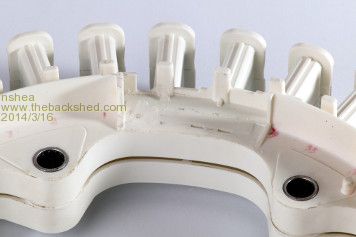

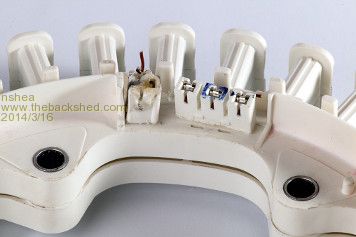

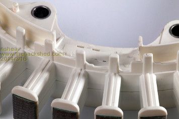

After unwinding all the damaged wire, I decided to remove the terminal blocks:
This PET (polybutylene terephthalate) or glass filled polypropylene (I'm not sure which) is exceedingly tough, and it took some shaving with a Stanley knife to get a smooth surface. The reason for removing the terminal blocks is to make room for the stator plate.

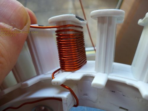

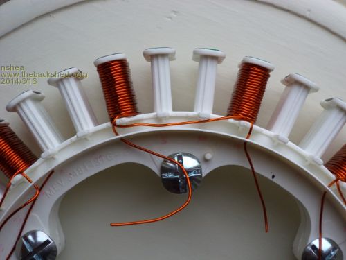

I was very reluctant to begin the first coil with my precious new copper wire and procrastinated for a long while in fear of making a pig's ear of it...

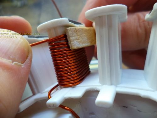

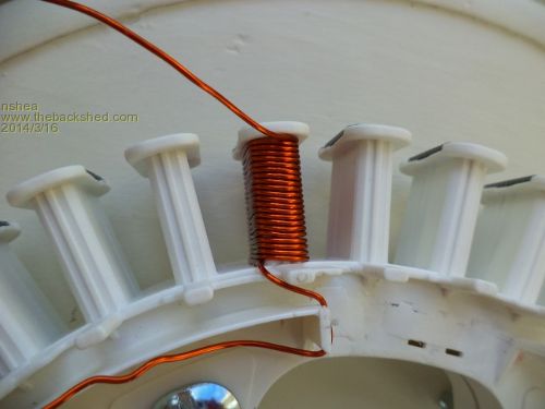

A clothes peg is useful to help form the wire round the pole. It also saves your fingers...

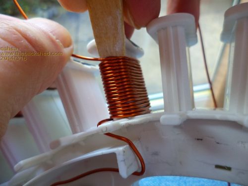

Winding a single pole. There are twenty one turns of wire spiraling upward in the first layer, with the second layer commencing the downward pass at turn twenty-two.
When using 1mm guage wire, there is only room for two layers per pole. The factory winding, (which used a narrower gauge), had four layers per pole. But the mass of copper in the new winding should give similar, if not greater inductance when using neodymium magnets
Generally speaking, increasing the number of turns per coil results in greater inductance (voltage); but the increased length of wire also means more resistance and therefore less current is able to flow. I am hoping that using fewer turns with a larger gauge will provide a flexible set-up with the stronger neodymium magnets…
Delta wiring will be used for large currents and small voltages, whilst Star winding will be used for large voltages small currents.

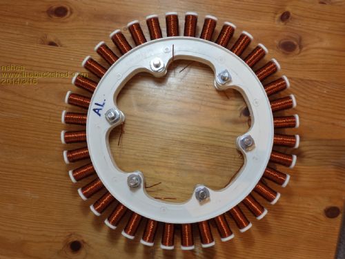

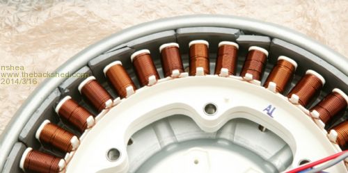

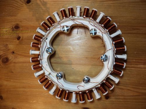

The stator was wound one phase at a time, with six pole pairs making up each phase. Each pole has forty one turns of wire, and each coil pair takes about an hour to complete.
I wound the first phase in six continuous hours, which knackered my thumbs for two whole weeks; after that fiasco, I wound two coils at a time, resting my thumbs on the following day. I'm serious though, this played havoc with my nigh-on fifty year old skeleton.
Phase two done...
Phase three close up.
Phase three complete from rear (so your can't see all my messy ends).

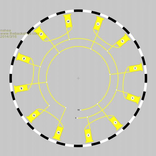

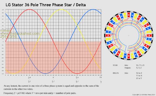

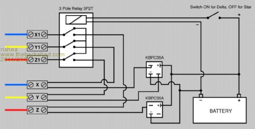

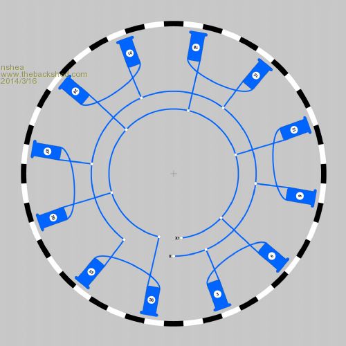

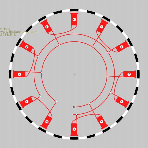

I will be winding the stator for three phase power as instructed by Glenn. Here are some pretty diagrams I did in Adobe Illustrator...
Phase One...
Phase Two...
Phase Three...
And a relay switch will select star or delta winding. The reference for this circuit diagram was sourced from Hugh Piggot's axial windmill pdf paper...

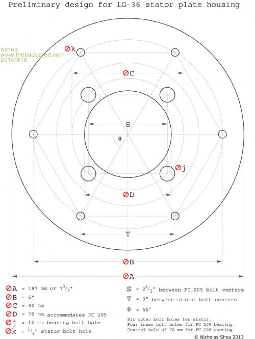

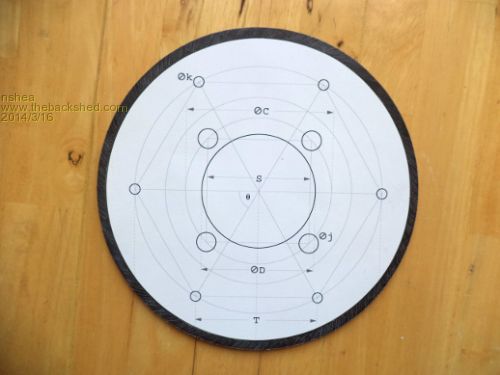

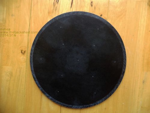

The stator plate is made from 5mm mild steel...
Laser cutting this beast is too expensive, so I bought a piece of steel with the nearest dimensions I could find:
The CAD drawing was printed at 100% and high resolution, then stuck on the plate. A very sharp screw was used as a punch to mark the hole centers. The paper was removed and white acrylic smudged in the holes. Originally, I tried scribing the design on the reverse using ruler and compass but one of the centers was 1mm out. The printout method proved 100% accurate.
Now I have some hefty metal work to do. This project will no doubt seem rather primitive to many "Back Shed" members - there are some very impressive windmills posted here. I have been lurking on this forum for a number of years, gathering information and confidence. I have limited resources and funds, so will probably be here 'til doomsday. I note that the subjects of "pedal power" and "depression" are both grouped in "Other" - and trust that the former is not a cause of the latter...Edited by nshea 2014-03-18

Hi Bruce,
My 36 pole F&P stator does not have a central bearing hole like the older models I've seen; instead it has six 1/4" bolt holes arranged in a hexagon around the perimeter molding. Once drilled, the stator plate will be bolted to these; the other holes in the stator plate are for the FC205 bearing unit. I uploaded a CAD drawing of the stator plate in my original post - it's just that the stator plate is shown before drilling...
I wanted something substantial because the entire plate will slide in and out of the rotor on the bearing shaft using a clutch mechanism. The clutch will be operated by a cable from the handlebars. The only difficulty I can foresee is in finding two clutch springs of correct elasticity. The plan is to put one spring behind the stator plate and another in front. These will help counteract the pull of the Neodymium magnets once the stator is fully home, thus easing load on the clutch cable. This is important because each magnet can pull up to six kilograms.

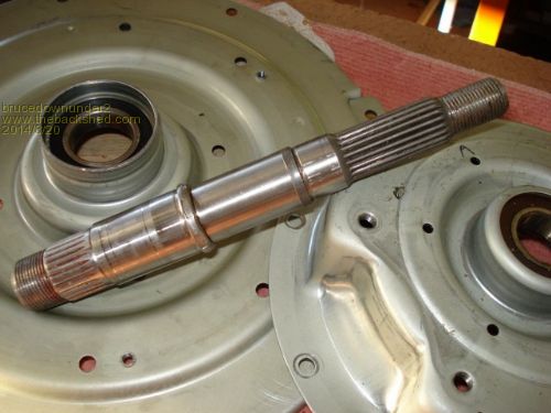

Thats a pic of the LG bearing/housing
Bruce
Bruce

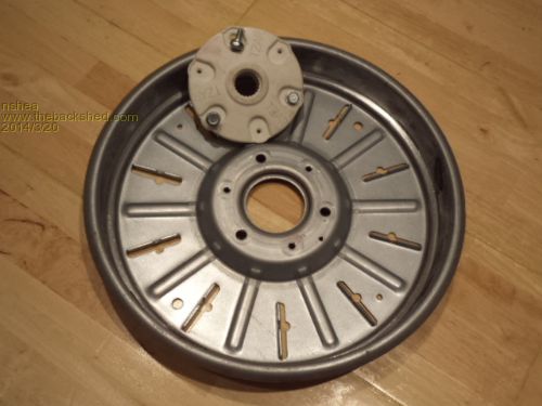

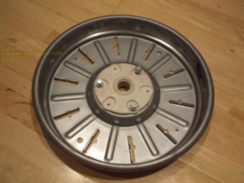

Ah! I see now. Thanks for posting that Bruce. Your LG rotor looks more substantial with regard to the steel central hub and its female shaft housing. The center of my LG rotor is "missing" in this respect, and the "hub" for the shaft is made from some sort of polybutylene terephthalate or polycarbonate. Whatever the material, it's extremely dense and hard - which of course, it should be. Here's a photo with this synthetic hub in position:
And here's another with it removed:
Note the remnants of the cracked ceramic magnets which I still can't shift - even with a chisel. Apparently, a blow torch will soften the glue to facilitate removal. But I'm worried that an uneven heat such as this might damage the rotor. An oven would be more gentle and even.
The iron flywheel from the "Tunturi" exercise bike seems made for my rotor though, because the hub on the flywheel is level with the pressed indent at the rotor's center - so I wont be using the synthetic "hub" at all.
