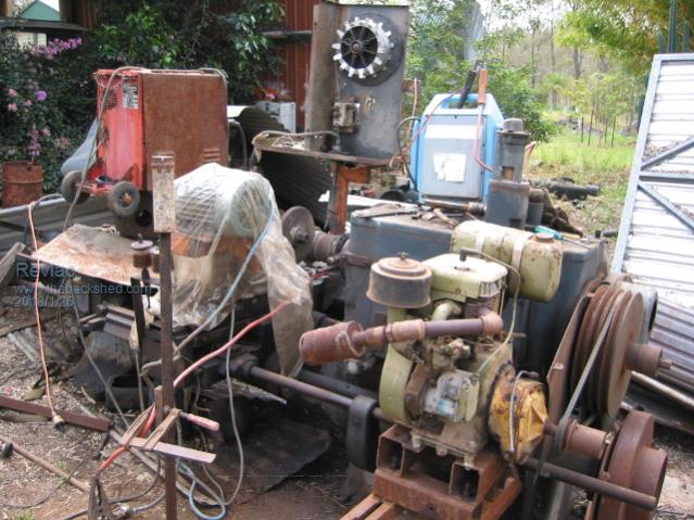

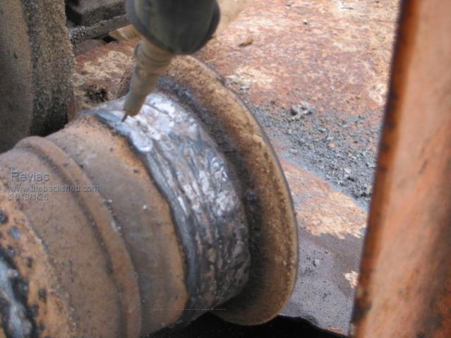

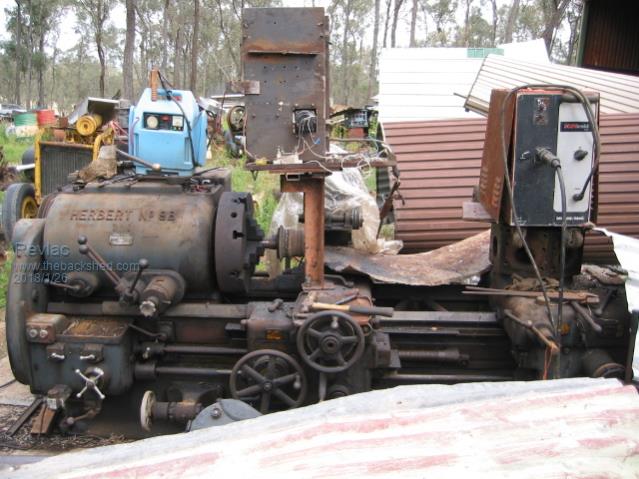

I had a 10T excavator that needed the track rollers building up a bit, I wasn't going to buy new ones as they are a bit pricey, so after thinking about fixing up all 12 of them I was not going to be stuffing around welding each one by hand.
Ihe idea was to use then old Herbert lathe to turn the rollers at a steady speed, the 15hp electric motor was already off so I cobbled an old wisconsin motor and reduction gearbox onto the drive, that gives a good low speed for continuous welding.
Used the old wire feed unit from the busted CIG MIG WELDER, mounted that on the tool post mount.
Made up a short cable and hand piece for the 1.6mm flux-core.
There is a large Copper strap rapped around the shaft that is welded to the roller so as not to weld up the bearing's in the lathe.
The Scanweld mig sitting on the turret did not have enough power to run that size wire.
I ended up running the 225amp tractorpac flat out to get a half decent weld, however running flat out for to long was starting to over heat the welder a bit, I could tell because there was a smell and a bit off smoke coming out of it.
Then We made up a half decent tool post grinder 2.4Kw 2900rpm, this did a good job using the power feed, although we did overload and stall it a few times.
The only real nuisance problem apart from everything overheating (Me including) was the speed control on the wire feeder, it would often stop the wire feed motor when starting the arc, but after some thought I reckon it had something to do with the reverse polarity from the welder when running with flux core wire.
Still I'm happy with the job it did in the end.

Just looking at the first photo on the left side, There were trees growing in the shed back then.
Cant seem to take a photo around here without seeing some junk in the background.

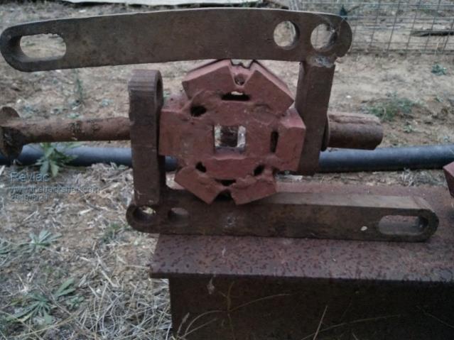

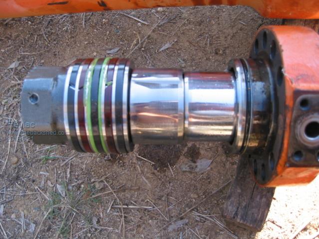

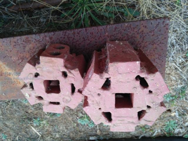

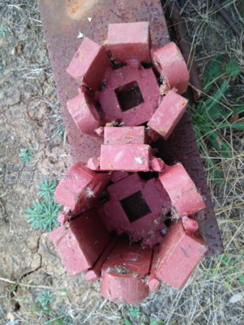

Had to fix the rams on the excavator some time back and was told I would have to take it to some specialist place to get the nut off the end, and apparently there weren't many places locally that could do the job.
Was also told it could not be done any other way...Hmmm well then, Worth the challenge, I'll give it a go.
Had some Hardox and some other bits of steel, welded them together as sockets 75mm and 80mm to fit the nuts on the end of the rams, also had a 1 inch square drive in the end if necessary.
Some more pieces of steel that connect on to the socket so a long bar/pipe extension could be fitted as a handle to turn the socket and and nut..The other end of the ram was held firm by another excavator,(don't hold it in a big bench vice it will tear it off the bench or tip the bench over).
Well, jumping on one 2.5m extension bar was not enough (see the bend in the steel bar), so add another 2.5m extension bar with the endless chain pulling it up while I jump on the other one, I could see the shaft twist and knew something had to give, eventually the nut started to unscrew.
Did the same for all the rest of the ram's, works well.

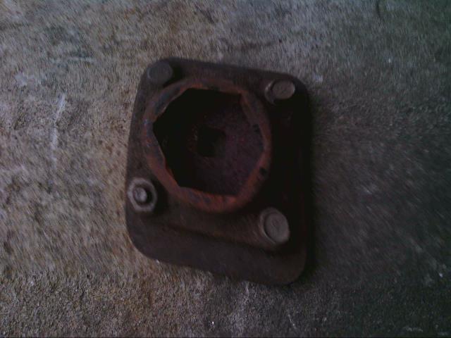

Was that nut fixed with something like Loctite to the shaft or did they use a gigantic torque wrench to fit it?
I'm wondering how you are going to tighten that nut again

Hi Tinker,
They didn't use loctite, they tighten the nut with with a powerful hydraulic torque wrench then lock it with a bearing ball under a grub screw, tighten that down and center punch the edge of the grub screw thread to stop that coming out...works well.
I tightened the nut the same way I got it off, very pleased with how it went and has never give any trouble since.
I did 4 all up and hopefully I don't have to do it again for a long time.

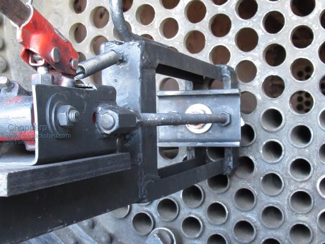

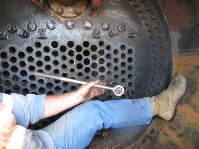

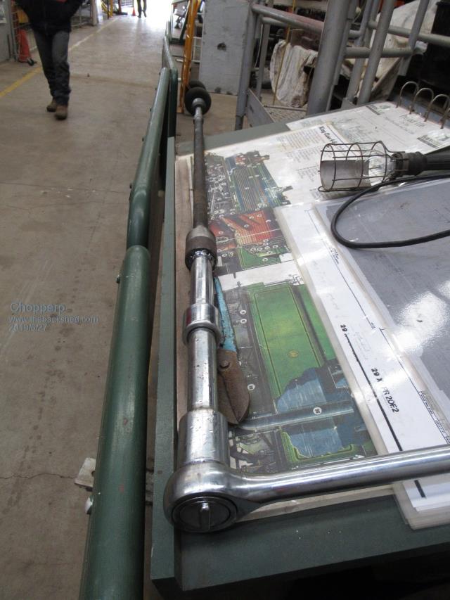

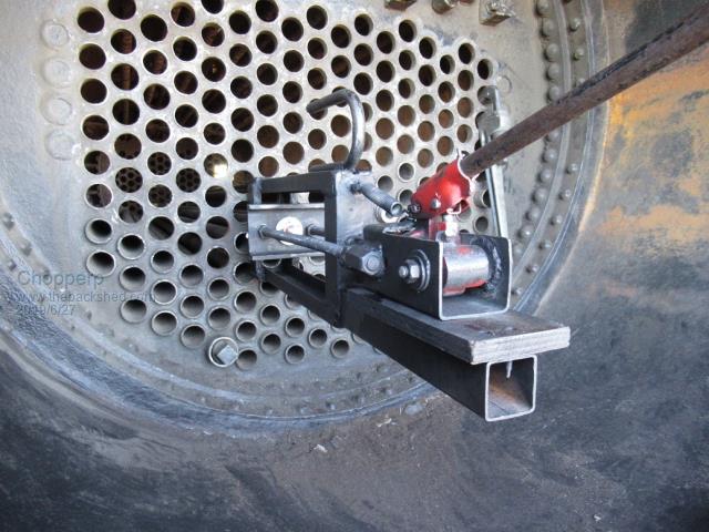

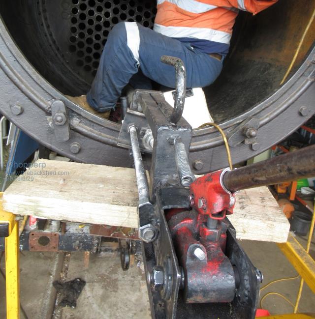

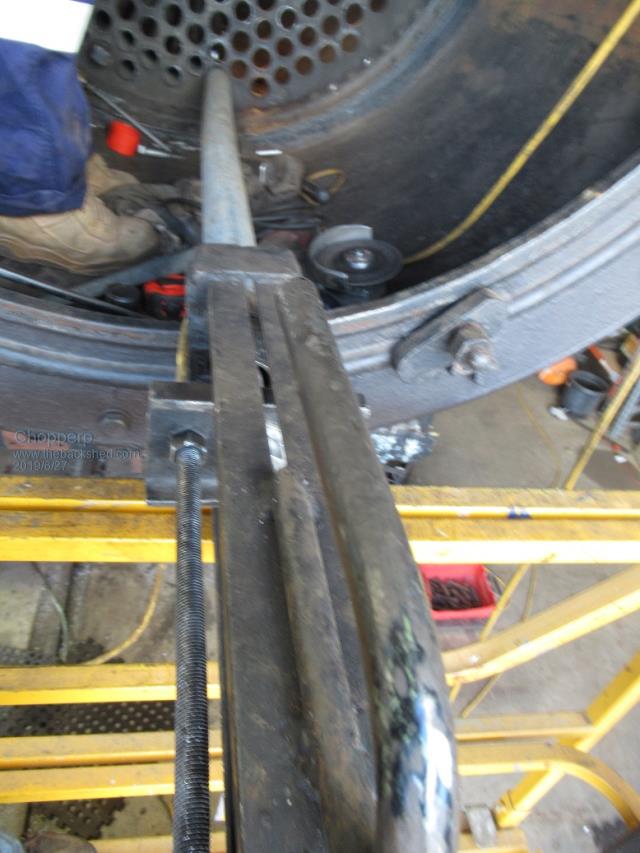

I have a situation where we need to pull out fire tubes from a C16 Steam loco (C106, originally built here in Toowoomba, QLD, AU) where I volunteer. 180 odd of them. The tubes were replaced a while ago but were not installed correctly hence the need for their removal.
Our initial method shown below was with a long rod with thread at each end & pulling them out by winding the thread up with a spanner with a Boss or die thingy over the pipe to come out & the threaded rod up the middle.
The far end has a similar fitting which slips inside the pipe but with a flange to fit the edges. The rod goes through that & fitted on with a nut.
Doing this was hard & awkward work & wasn't getting any easier. We then made up some extensions & used a 1" drive sitting in a scissor lift on the outside of the smoke box. (Thanks Aaron for that photo)
This arrangement was better for a while until the smoke box door started to get more in the way.
I had been toying with the idea of modifying a trolley jack to use as a puller & eventually got around to designing & making a prototype. This worked well & with a couple of mods, it worked even better.
I knew that we could not use the puller for all the tubes as it was. Today we reached the point where we needed some more mods. Extensions were made so we could use the puller outside of the smoke box resting on the scissor lift. Bit more awkward to use, but still worked well.
175 odd tubes removed. 8 to go.
Our process for removal ended up as follows.
- Grind the far end of the pipe down flush with the fire box plate.(The pipe is still expanded at this end)
- Insert the rod, fit the boss thingy, put the pulling gear on the smoke box end & try to pull about 200mm of pipe out. Normally the far end (Fire box end) of the pipe requires a bit of persuasion with a big hammer to get it going.
- Depending how the pipe initially comes out, we are either:-
- able to pull it straight out. (easy ones, only about 10%)
- pull the pipe through as far as the smoke box plate, cut the pipe & push the end back into the boiler & fish it out a bigger hole (don't ask)
- cut the pipe off at the 200mm mark, push (Belt) the remaining length of pipe back into the boiler & pull it out a bigger hole. This is how we ended up doing most of the ones.
Remember, these tubes were not fitted correctly.
Hope this makes some sense.
Photo Below: Original method. We had to either push or pull on the spanner depending on the location of the tube. Not easy at times especially with a round floor & lack of height.
Below. 1" drive extensions. Enabled work to be carried out in the scissor lift outside the smoke box. Much better
Hydraulic puller after a few mods
Puller business end
Puller with extensions to gain access to difficult tubes
ChopperP

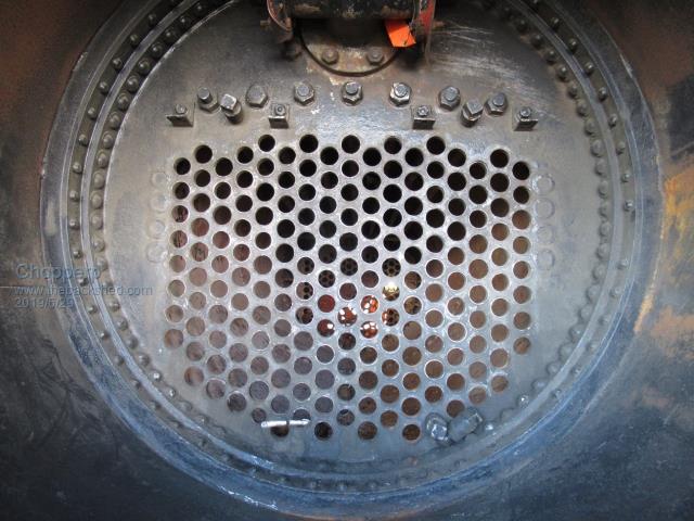

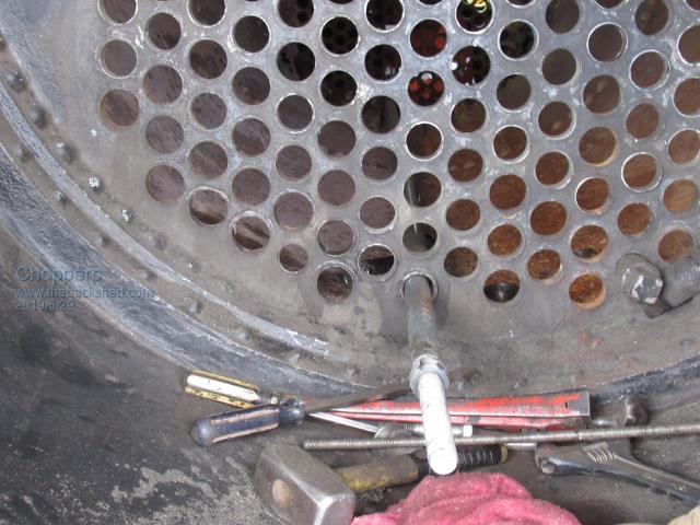

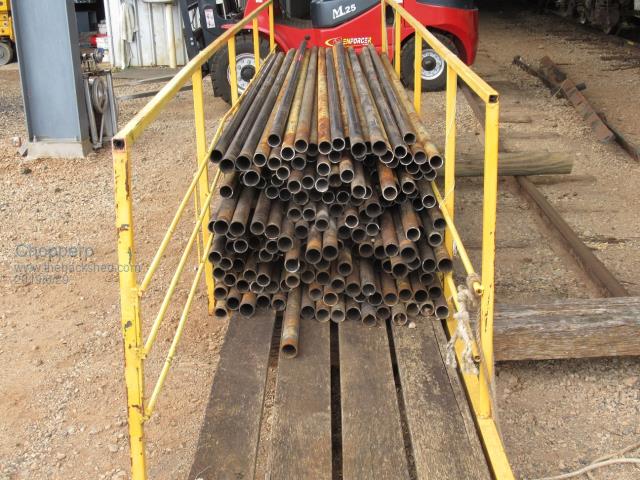

All tubes now removed.
Still much work to be done ( & money required) to get the old girl up & running.
@ Tinker link to PDF on tubing. Yet to read it all myself. This assumes the tubes have been put in correctly in the first place.
tubing
Some Photos
Pull Rod in Final Tube
Puller on the Rod. Tube just come loose.
Smoke Box Plate
Within The Firebox
Stack of Tubes

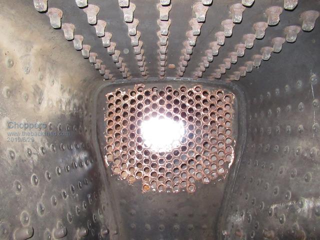

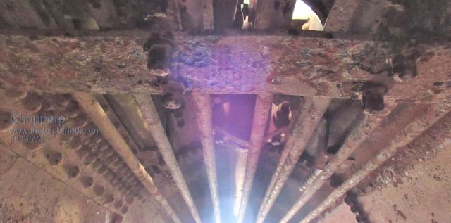

Photo below of the top tie rods viewed from the firebox end. Some of them will need removing so we (someone young & skinny) can get inside the boiler & clean it out etc.
