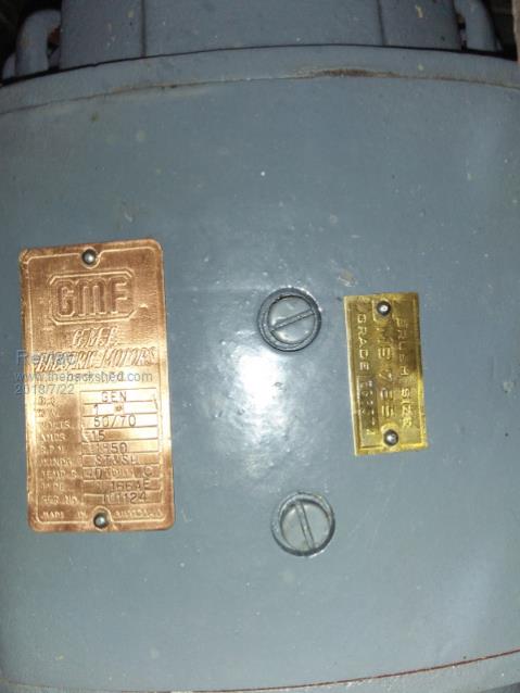

Gday everyone,
I have been given some equipment( old motors) that needs painting.
I wish to remove the name plates and specification tags that are held on by Drive Screws.
https://www.rivetsonline.com/drive-screws#1
I guess you will all be familiar with them. Is there any way to remove these from cast iron housings? Ideally I dont want to grind them off as it will be hell to drill them out ( about 1/8"/3mm dia. ). I have has success with transformers, but it seems laminations dont hold them in as well as cast iron.

I will post a couple of pics tomorrowEdited by joebog1 2018-07-23

Nope, they are not always easy to get them out, sometimes have had success using a ground down chisel and carefully work around them without damaging the nameplate.
failing that, often the hole that they are in is drilled deep enough to just punch down further if the top is busted off.
You may have to drill new holes just beside the old ones, and hope the nameplate can still cover them.?
Recently did some name plates, worked Ok.

Yah, Revlac has it. I think I will try using a dremel tool with thin cutting disc, make a screwdriver slot as it were.
