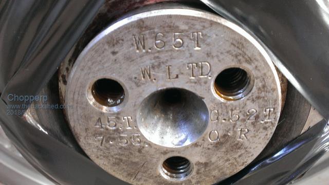

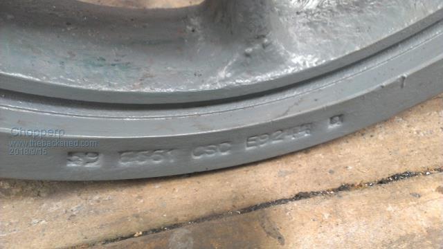

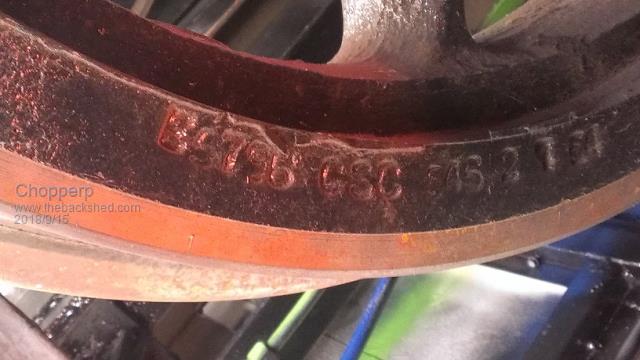

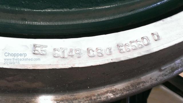

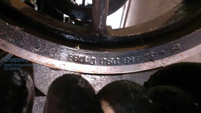

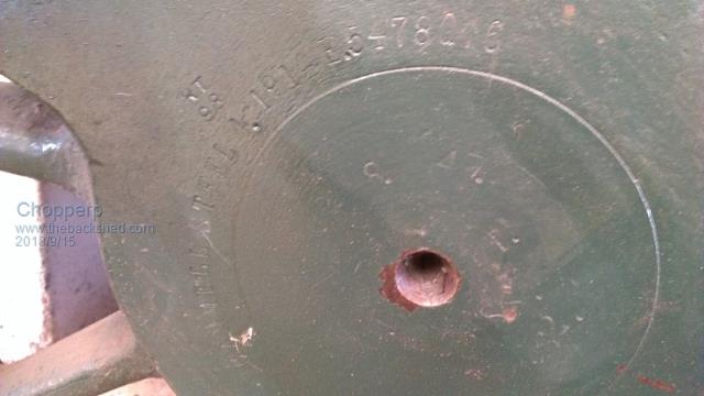

Some rail rolling stock axle & tyre stamps accessible in our workshop.
Some photos not that clear. Some rotated to get stamping roughly horizontal
Most appear to just have the year of manufacture plus serial numbers.
BTW, the steel tyres are heat fitted to the actual wheels. The running surfaces have a standard profile with tolerances depending on the application. They can be machined to get back to the correct profile. Once they get below a set diameter, they need to be replaced.

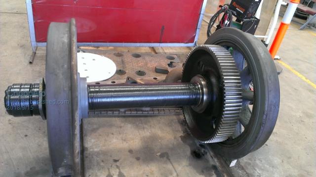

The last photo shows an axle ready to be sent away to get the wheel tyres re-profiled. It was not in a good condition when removed from the bogey & the traction motor removed from the axle. Hadn't been serviced for years prior to decommissioning.

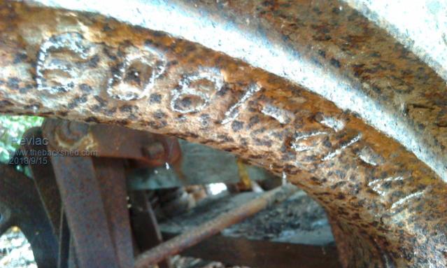

They are heavy looking wheels, not something one could lift by hand and stick in the lathe to fix. HaHa .. Used to do that with smaller scale, Model railway gear.
I would say most wheel sets would likely be original (The wheel itself) unless some get damaged at some stage, There could be a few different axle changes in the life of a wheel set/bogey and numerous tyre changes depending on service life, might be lucky to see a wheel set that has matching dates all around.
I have a picture of the date cast into the wheel on an old bogey, can see the date as 17-12-1909, perhaps I could have rotated picture, I'm not up to rotating the wheel.
This wheel did look similar to the DP13 wheel from a distance.
Its the odd wheel/Axel out of the 2 bogeys here, the axle date is 1969 and 40t, I'm not sure what the numbers on the tire's mean.(picture did not upload)

The Loco axle will be send to a local firm which has the only lathe big enough up here to handle it. Expensive but we do get "Mates Rates". There's a 6-8 wk turn around time at the moment. This one should be relatively easy for them.

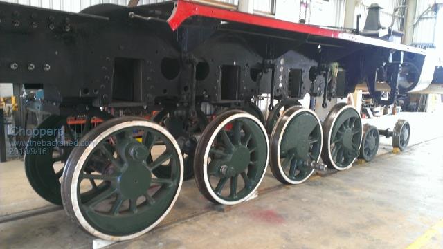

(They had fun doing the Steam Loco ones as they have counter weights built into the driving wheels. They had to be balanced prior to machining. See Photo).
Speaking of damage. We did notice yesterday that some of the "spokes" on one of the Loco wheels were bent a tad. May have been a "Casting Error"
Some more Piccies FYI. Was looking of one of DP13"s wheels but couldn't find any.

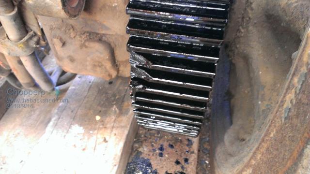

Other Drive Axle Showing 2 of the 4 Chipped Teeth. Hopefully, they can be repaired.

Steam Loco's Wheels back from being re-profiled
So chippen teeth can be easy repair by using special welding method so if you need help please send PM

Just to let you know that i will call in railway workshop on Thursday morning as i just want to find out what grade is steel cast is ? however i can weld cast steel or cast iron is not big a problem.

We were wondering today about the strength of the repair weld at the joint.
Also, we think that the teeth were broken when the wheels were re-tyred.
I plan to be there on Thursday

I was thinking maybe something fell between the gears at some stage.
but that could also be the case when they re-tyred it, Find any bits?
I have found some odd things in the bottom of a gearbox, and parts in the bottom of an engine sump, heard some jokes about that, or maybe they where true.

There are hammer marks on the sleeve halves that fit between the wheel & the tyre. So violence was used on it at sometime in it's previous life. Suspect a "Knockometer" hit the gears. No bits were found in the messy gunk at the bottom of the "Sump".
The wheelset with the good teeth is at least 25mm smaller in diameter & has no evidence of being mistreated. Most likely hasn't been retyred.
We think if something did fall into the gears it would have damaged the motor gear and / or bent the motor shaft.
