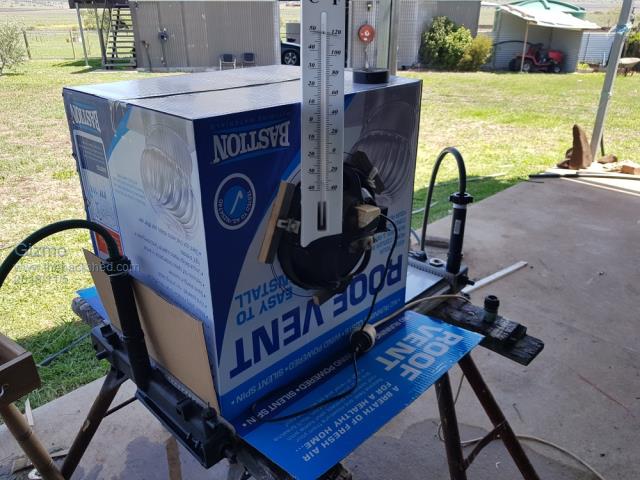

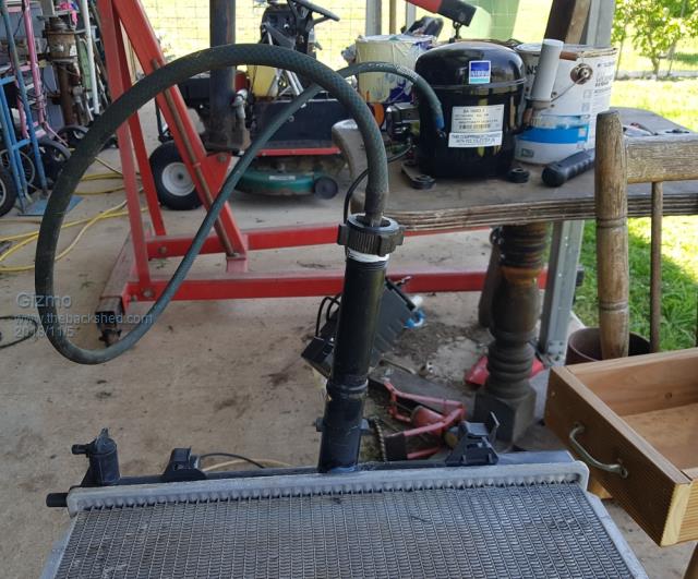

I did a little experiment.
Its hot here in summer, and I live off grid. Cooling during the day is easy enough, I can run the air conditioner for my office and the solar system is more than up to the job. But night time is a problem, the house is insulated, meaning it likes to keep the heat in at night and can take several hours to cool after the sun sets. I can open a few screen windows to let the air change, but these hot nights are usually still and full of tiny bugs that climb through the screen and make life miserable.
Now I have a water bore near the house. The water temperature from the bore is 22c, all year, all day. I have a 24vdc pump, draws about 80 watts and the flow is like a garden hose half on, see picture.

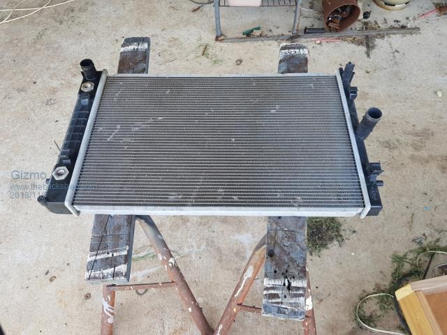

Could I use this cool water to help cool the house? Time for a experiment. I have a radiator out of my Commodore that started leaking under the header tank gasket a couple of years ago.
Fitted a couple of 13mm hose fittings, then connected up a vacuum pump, and sucked it down. Applied some gutter silicon along the leaking edges, vacuum sucked it in, and let it cure, so I now have a water tight radiator.

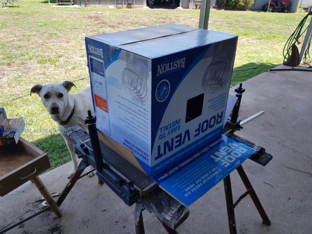

Found a cardboard box.
Fitted a old 200mm bathroom extraction fan to blow air out, a thermometer in the air stream, and I was ready to test.

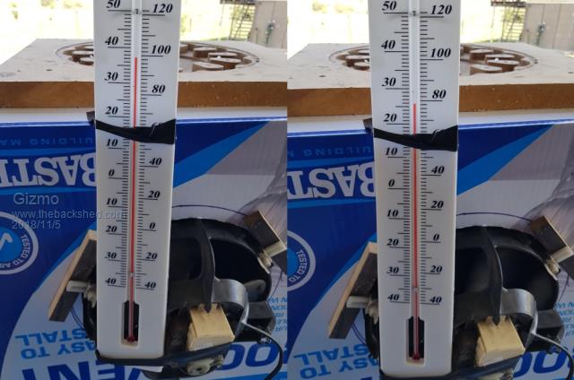

Warm day, just over 37c. Started the bore water and the fan, and after a minute the air leaving the box was 26c! Inlet water was 22.5c, outlet water was 28c.
Now this thing is drawing 100 watts, 80 for the bore pump and 20 for the extraction fan. I can run that all night easily. So I'm thinking I should make this properly, and put it on a stand inside the house. The outlet water is fed to my water tank or garden sprinklers, which I do at night in summer anyway.
I dont know the flow of the fan, but its a nice breeze coming out of the box. I dont know if it would help cool the house at night a lot, but it should help, for very little energy cost.

It will work fine at night, all the way down to 22.5c if your water is 22c.
edit "if you are recirculating inside air"
There are some who use covered over insulated inground pools or large buried water tanks in residential suburbs.
For a captive water source however it needs to have some sort of spray cooling or the water will heat up to nearly ambient temp.
In your case, you have the added bonus of winter heating up to 21c without changing a thing.Edited by M Del 2018-11-06

I'll make up something a little more sturdy and set it up in the house to try it out. The only issue is running a couple of hoses through a window and keeping the bugs out, but if it works I'll mount a couple of fittings in the floor inside a cupboard.
As I write this its 9pm, 31c inside the house and 29c outside, and a million bugs at the windows looking for ways to get in. Nasty.

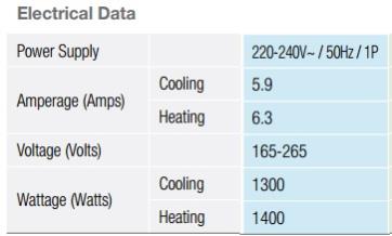

I think the water cooler would work BUT if the aircon is not coping with its 2650 watts of cooling power, or whatever it is, I dont think the energy absorption of the water can match that.
Off the top of my head you would be trying to remove 9500 kj per hour to match the A/C, that seems like a lot of heat getting in for a compact house. that is a lot more heat that a fridge and computer running, body heat and the odd cuppa. With no wind putting air pressure on the outside surfaces the only thing I can think is that the house is maybe leaking and drawing quite a lot.

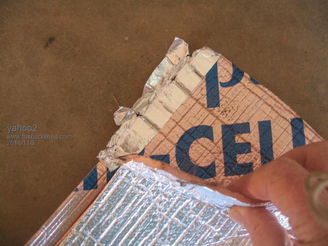

its called kingspan aircell
we had no room to install it under the timbers so we placed it on top, glued the bottom edge to the fascia, aluminum taped all the joins.
Then we put a 18mm fairing strip on top to create an air gap under the iron for the air to flow to the pitch of the roof then out.
its not perfect or by the book but it works. There is a second larger air-gap over the insulation. the house has vaulted ceilings so no roof space at all.
There was no condensation in the insulation over winter, I thought we would have to install a small section/strip of vapour permeable membrane just under the pitch of the roof to let the water vapour out.Edited by yahoo2 2018-11-09
