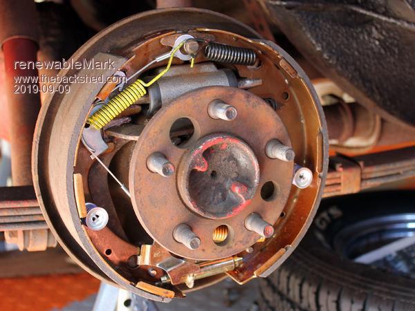

This is what I am familiar with (pic ripped off net)
What are you tightening to cause a lockup?
