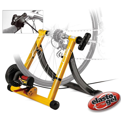

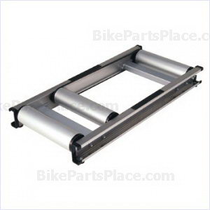

One thing I'm thinking about is bolting a generator to a bicycle trainer as these:
or
Should be relatively easy, and should be able to use all the bikes as powergenerating devices that way. Could use a basic, non-modified bicycle. It's project number 143(c) at the moment, so low priority, but that could change once I can scrounge such a trainer. The generators for it I have already lying on the shelf, so shouldn't be too much work to build one.

Secondly, if you look at the second picture you posted, that little
contraption is basically a bicycle dynamometer sort of a thing. It looks
impossible to ride, but I had one and it's actually really easy as long as
you keep your focus. If you look away even for a second, you could find
yourself hitting the tarmack "at speed" and hurtling across your garage
floor!
My point here is, this is basically a design I cooked up to let a car's drive
wheel(s) sit in and turn a generator for remote-site electric power.
I never built the car-sized model, but I can tell you one thing for sure: If
you put a generator on it similar to the first picture you posted, you'd
better have a way to engage and disengage it or you'll never get it
started. You'll need your wheels spinning, so their angular momentum
keeps you upright. Installing a little generator really places a drag on the
wheel being situated on the circumference of your wheel.
