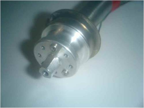

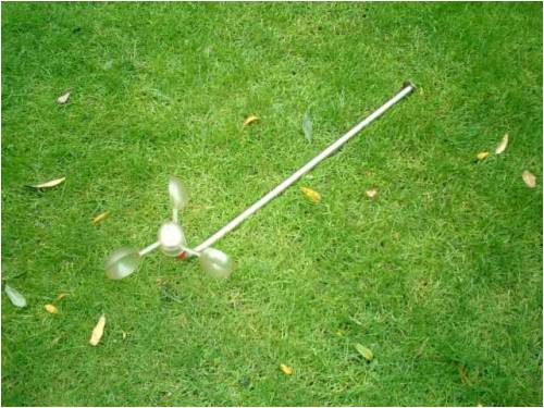

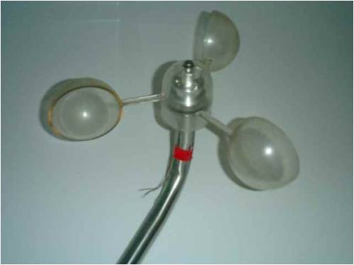

Just another anemometer project. Nothing fancy, but made entirely with scrounged parts.
The anemometer vane was bought 2nd hand a long time (~15 years ?) ago at a boat market. Don't think it cost me more than 1 guilder (0.50US$) at the time, brand 'Vetus'. Rather than trying to build something like the vane yourself I'd advise to buy it at a boating supplier, as it's a regular replacement item for anemometers (on boats pieces of rigging tend to quickly damage those fragile vanes).
The motor is an old harddisk (HD) motor, 3-phase output, about 1Vac maximum at the normal anemometer speed range. The motor is installed in a piece of bent stainless steel pipe on a welded-on flange. The flange prevents too much rainwater 'creeping up' into the motor. Time will tell if this is enough moisture protection. The output is sent over 3 wires (yet to be installed; it has been tested, but still needs to be 'finished up') to a 3-phase rectifier made of germanium-diodes. I initially tried using just single phase rectification but the rectified AC is just to bumpy at these low frequencies, with the needle of the meter vibrating a lot. The 3-phase rectification solved that.
I made an aluminium adapter to attach the rotor vane to the HDD motor, filing a 6-sided outer-hex 'nut' to fit inside the vane. The adapter is attached to the motor using 3 stainless steel screws.
Still have to install the cable inside the steel arm and calibrate an analog meter (that way no external power supply is needed; the anemometer provides the power it needs for its own readout), but apart from that it's finished. Made entirely from scrap. And, another use for old PC parts... after the PSU, now the HDD motor can be put to good use too. Maybe it's time for a new 'scrapheap challenge': build a windturbine out of old PC parts...

Some years ago I made my own cup type anemometer head using three Andronicus coffee spoons (they came in the tin). It lasted for a long time, but the cups ultimately failed due to UV degradation which, I suspect, might also be the ultimate fate of Peter's aenemometer head (which looks to be clear plastic and thus even more susceptible).
Unloaded cup type aenemometers have a rotational speed that follows the wind speed in a very linear fashion, however, I suspect that any sort of loading (such as self generating a voltage output) will affect the linearity.
In my case, I initially used a car distributor type Hall effect scanner, but the magnetic field as the vane pased through the gap produced drag that seriously affected linearity. I finally used optical scanning with a LED and photo transistor to overcome this problem.
No doubt you could build a big enough head so that a small loading would have minimal effect on the linearity, but it is something to consider.

You're right about the degradation under the influence of UV light and the weather. I bought the anemometer vane used at a boating show for peanuts and it shows some sign of wear from previous use. The good thing is that it is a standard replacement item from Vetus/Den Ouden (yachting supplier) so should be easy to replace when the need arrives.
The non-linearity is indeed there. In fact, the original Vetus anemometers are very non-linear too, compensating for it by a specially calibrated analog readout. I still have to build an (analog) readout unit for it, but I intend to make a custom scale for it. As long as the scale is correctly calibrated I don't really care much for the non-linearity: my major requirement is that the entire windmeter must work stand-alone, without need for external power. In essence, this anemometer is a VAWT that generates its own power for the readout display. Any kind of Hall-effect sensor or light-bridge would need an external power supply.
