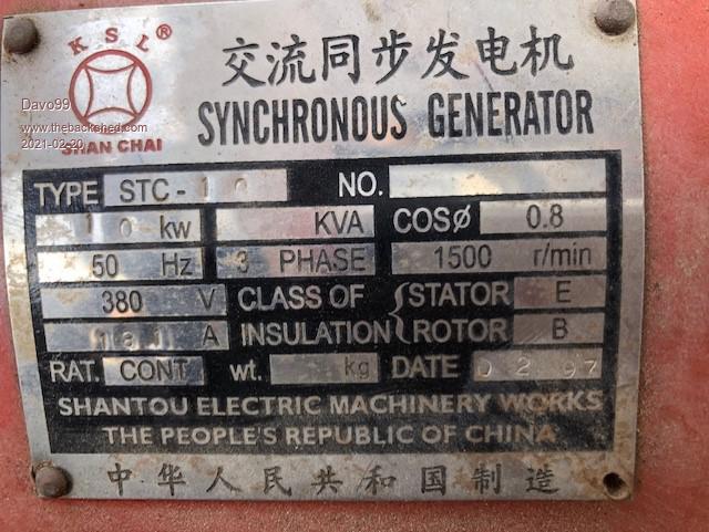

The generator is pretty much what I wanted alternator wise and is 3 phase. These things are so hard to get and rarely come up and never within decent distance of me.
Did a bit of wheeling and dealing and owned it.

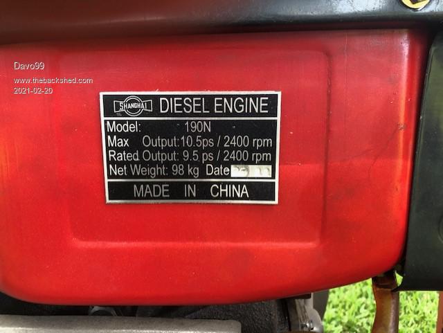

I notice there is no stamping on the weight specification.  The engine is around 100 Kg and it's clear by the balance the alternator is a lot more than that.  I tried looking up the weights but they seem to be like a lot of other Chinese specs, whatever sounded good to whomever was writing the info at the time. Seem to be anything from 100 to 150 Kg and I'm determinately leaning to the heavier side just like the thing does unless I put the forks right to the alternator end of the frame.

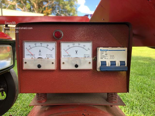

It's wired for single and 3 phase output which is good and saves me the trouble.
I noticed the bearings are a bit noisy even though the guy said the thing was new and had only done a few hours for testing.  I'll pull them out and look at greasing them or putting something better in.  Maybe the Yak fat they factory lube the things with has gone a bit dry?
The engine, thats something else.
I bought another one this week  oddly enough but it was just a little 4 Hp watercooled. Even that weights 60 Kg so I think they are under rating this one bulk wise.
I tried spinning the thing up as it's hand crank only.  Admittedly I'm only a little bloke at 6'3 and just got below 110Kg and fitter than I have been in a while but it would take a much better bloke than me to spin this thing into action! I can't imagine how some little 50 kg Asian bloke would do it. Come to think of it, I can't Imagine how the strongest, fittest people I have known would.
I thought it must have a lot of revolving mass in the alternator so I slipped the bely off and if anything it made it worse.  There is still definite compression resistance with the decompressor activated but instead of the alternator smoothing it out, you can definitely feel it. They guy seemed impressed when I said this engine is too small to get full power out of this alternator, I guess you down sized it on purpose but what will it pull? He said it will do 8-9 Kw and explained that a lot of the people where they were used had no Idea of power consumption and would plug every appliance in the village into the things so the alts had to be safeguarded.
The guy said he still has alternators and electric starter kits for the things so I'm interested to get one off him. He said the fuel tanks had to be replaced with smaller ones to make way for the ring gears on the starter flywheel  But no problem to me. I'll just mount the tank on the top of the frame and extend the fuel line.
I am still wondering how in the hell they ever hand cranked these things though?

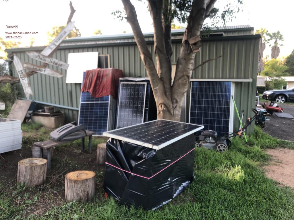

On my way home with the engine, I came across a lot of panels that have come off a factory roof. About 800 250 watters.  Unfortunately, and this irritates the living Crap out of me, the installers have cut a lot of the cables. Not just the ends off but to about 4" from the junction box.  I can't stand lazy tradesmen that do this but that's another rant.

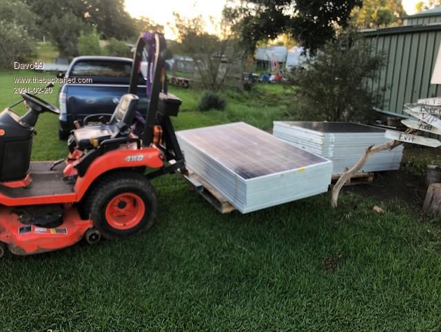

Anyway, went back and Picked up about 50 of them so far, most that have the leads and a few with one connector missing but a decent length I can put another one on.  I can see I'll get 100 Out of the pile and beyond that, don't know.  Have to work my way through the pallets but the first 2 were all cut off. Different people doing them I spose.
They are good quality panels and I'm pretty sure I know why they were taken down. Probably falling output...... From all the damn Lichen on them!
They probably could have had them cleaned and the things would have been fine.
Anyway, I'm not complaining other than about the cut leads.  I might Pick 50 or so of them up anyway and use them for the carport roof beside the shed I want to build.
I'm putting these things on pallets so I can move them round easy and not push the shed over from all the ones I have stacked there to go on my own roof... when I can bribe my daughter to help me again.
I had someone come round and buy a bunch of other panels I had so that was a quick return against the cost of the Genny.
The solar table with the black plastic underneath is the Genny. Going north to visit and help my Dad for a couple of weeks so It's going to have to sit there till I come back.  Also the wrapped it up apart from weather proofing was The mrs Doesn't know about this latest acquisition as yet. I did tell her I was going to buy a Big Genny this year but probably wasn't expecting one so Quickly. Neither was I actually by a long shot.
I'll get in the good books by cleaning out some other crap first and then I can tell her when she does see it I bought it years ago and just dug it out again. :0)
Funny though, when I asked her to bring me home the cash and she asked what I wanted it for, I told her Hookers and Drugs and the money arrived. She did ask "what solar panels I was buying now?" though.
She did say this afternoon, you bought all those panels and now you got all these for Free?  Umm, yeah, it's OK darling, I'll sell them and we can put the money back in the bank.
I'm a bad, bad man!

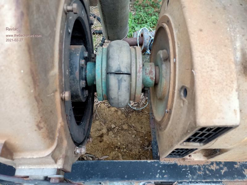

My farther and I built a coupling for a genset we were rebuilding, the original motor had blown up and the genhead had a crook Bering.
We got hold of a good size old truck engine and coupled her up to the 63Kva or 68Kva Stamford, it has been going well for years.
Years ago we had this little 3 Cylinder Lister diesel with a 14Kva genhead, it had a great big cast coupling with a thick flexible rubber plate in the coupling, that worked well for many years.
It was getting on a bit and we thought we would try the big lathe as it could do with a service run to keep all the gears lubricated, the lathe motor was 15HP DOL start......(there's your first clue).....hit the start button on the lathe and the 15hp electric motor started to turn, then the contractor tripped and could here the geny loaded to the sh$thouse but picking up speed again, after hitting the start button again everything got up and running ok.
Nice, first time the big lathe had run, then we pulled the 2 way clutch for a higher spindle speed.....HUGE BANG from the generator shed and black smoke filling the shed, waited for the smoke to clear and had a look in the generator shed, Lister was still running nicely at 1500Rpm, shut it down to find that big coupling had blown to bits, split at the key-way on the shaft.
One big piece of coupling hit the fuel tank and caved the side of it in, the other piece hit the wall and the 3rd piece we never found, even after cleaning up the place and moving out.
We worked out later that the other big piece flew out the side of the shed past the carport past the driveway and landed somewhere in the neighbours bushy yard, couldn't have gone anywhere else.
Since then we built some of this coupling for the genset, I think the rubber tire part is fenner dodge , its done another 20+ years on that and still going.

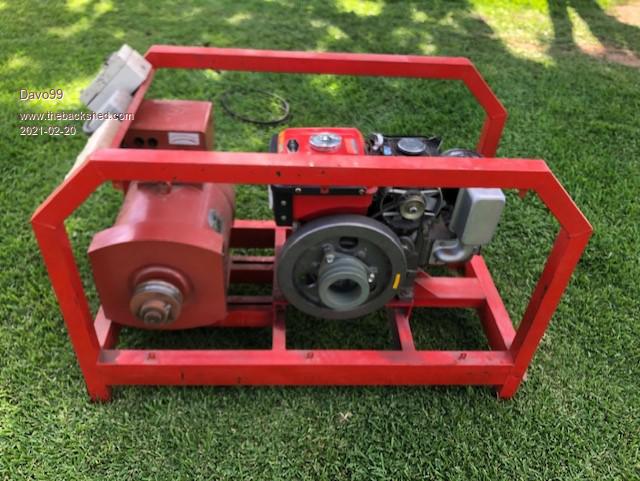

Couldn't find the spring I wanted to use for the tensioner and Bunnys had nothing suitable so I went with the turnbuckle which works fine.
I have the thing on a concrete block atm which probably weights over 100 Kg with the complete setup. I did find some flat 4 Wheel trolleys up the back so I might put it on one of those for better mobility. Going to do my back in moving the thing around the way it is and it's too awkward to carry down the stairs at the back of the house from the lawn to bring it down if I want too.

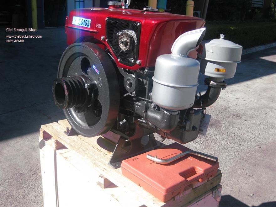

One that works ok is the 671GM Grey Marine Diesel, the heat exchanger will do a perfect job heating some water.

Due to the angle to where it is secured on tha alt and the framework, when I tensioned the belt up the buckle bound on the alt casing a bit.  I thought I can just bend the end of the  buckle to clearance that then I thought, hang on, what I want to do that for? The belt is a good tension now and won't unwind itself. When the belt stretches I may need to get a bit more travel in the buckle but i'll try and keep the " Self Locking" feature in place.

  Quote  One that works ok is the 671GM Grey Marine Diesel, the heat exchanger will do a perfect job heating some water.
I'd sure love a 6V71 to put in the old dodge Truck. Turbo it as well and really have some fun.
