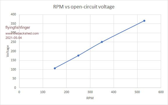

Right, got some more information. I appear to have a 42-pole 60s F&P, and did the drill test to find open-circuit voltages:
I'm guessing keeping the RPM lower will be better for bearing lifetime - but otherwise I'm still unsure how to pick a target.
I feel like I'm missing something fundamental here, though. There are too many variables that I'm not sure how to eliminate properly.
For example, if I pick 500RPM and a 20cm diameter Pelton wheel ($50 on Ebay), that's 10m/sec on my jet velocity.
But, if at max power the RPM is cut in ~ half, do I size the jet velocity for that instead?
...I have too many questions, sorry. Newbie here

If you use proper ball bearings, they should last forever if you can keep the water and grit out.
Suppose you measure your nozzle flow velocity, and find a suitable turbine wheel that spins at 500 rpm unloaded (for example).
Fully loaded it will be slowed down to about 250 rpm and perhaps a theoretical 170 volts.
It will be less than that under electrical load, possibly about ten percent less when used as a generator.
So let's assume 150 volts rms phase to phase under load for this example.
Now if you are charging a 12v battery to about 14.3 volts with an MPPT controller, the controller will need some extra dc voltage to work from. Probably about 18v to 20v perhaps.
That is when its all working properly under load.
If you disconnect the load, the voltage from the F&P might immediately double as the turbine speed doubles.
And you might easily see 36v to 40v (or more) at the MPPT controller input.
That might sound ridiculously high for a 12v system, but it would actually be about right, and what you need to do the job.
For this example only, you might need a transformer and rectifier to drop 350v (at 500 rpm) down to 40v dc under no load, or 150v (at 250 rpm) down to 18v to 20v dc t full load.

Ah, you guys replied while I was adding the bit about the jet velocity to the chart.
But ok, this is very useful.

Posted: 02:04am 04 May 2021
Its not too bad.
Once you have some basic test data to work with from both the nozzle velocity and F&P rpm/voltage characteristic, you can then select a suitable turbine wheel diamater from what is commercially available.
Its then a case of some further testing of the running turbine to find the maximum power point which should coincide with about half the unloaded wheel rpm.
Whatever voltage and current you end up with from the F&P can then be matched to the input requirements of your MPPT controller with a suitable transformer ratio.
Its all pretty straightforward engineering.
Cheers,  Tony.
