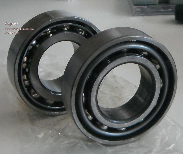

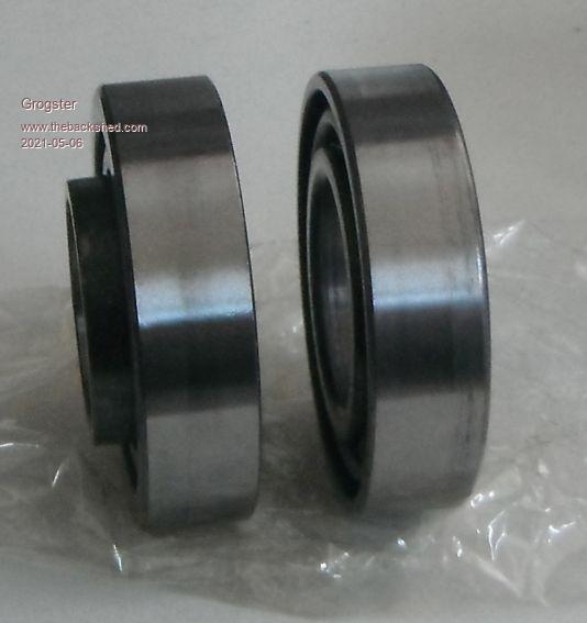

  johnmc said  Some morris vehicles had deeep groove ball roller bearings and a spacer in the hub to maintain load on the bearings and no adjustment for wear.
Yes, that is exactly what I have here.  An inner and an outer bearing, with a spacer between them in the middle of the hub, with seals on both sides.  When you do up the driveshaft main nut tight, it squeezes the bearings and spacer together, and there is no further adjustment.  Any serious play in the bearings, means you have to replace them, you cannot adjust them.  Although, one chum of mine here HAS adjusted them before, by turning a few thou off the spacer in a lathe, then putting them back in.  That allows the bearings to be squeezed up a little more, and take up the play.
The brand new bearings are interesting, in that they come with 'Half a spacer' as part of the inner race, and you install them back-to-back in the hub and do up the driveshaft nut, and that squeezes them together.  But there is no 'Floating' spacer, half of the spacer is on the inner bearing, the other half on the outer.  Clever.

New bearing with 'Half-spacer' on the left, old one on the right.

Also they are made that way because, they are angular contact ball roller bearings and should be fitted only one way.
cheers john

Just in case I did not explain myself clearly
bearing fitted   > <  angle of ball bearing contact to bearing tracks  opposing each
other.
cheers john
