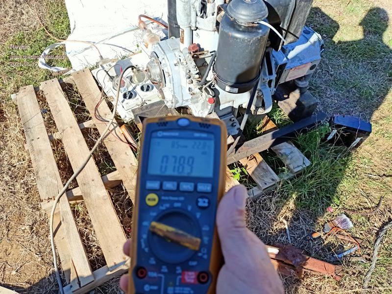

Tried me friends Hatz motor, Markon generator, He Didn't run it very often on his house block as it is too noisy for the Neighbour's.
Started it and measured with a sound meter (Don't know how precise) and at 1m away it is about 80db, and about 70db at 5m, noisy bastard, its mostly engine clatter and being air cooled ads to it somewhat.
The ambient noise around here was measured at 55db and when the little birds get going (feeding time), at 1m its 110db or more.
So if any sort of sound insulation can drop that sound level by about half, that would be pretty good I would think.
I thought I was a noisy neighbour around here, starting a big engine with no exhaust manifold on, or mowing with the tractor and a branch grabs the exhaust and rips the muffler off the engine, but no, some other have far exceeded that noise level.
Others times, usually winter we get some times that are almost silent and you can here people talking 1.5km away, even further sometimes if someone says f  out loud, after hearing that its best to take a little more care with whats being said.
For a generator or motor, I would just enclose the entire unit first, see how it goes then tackle the air intake and any other parts if it needs it.

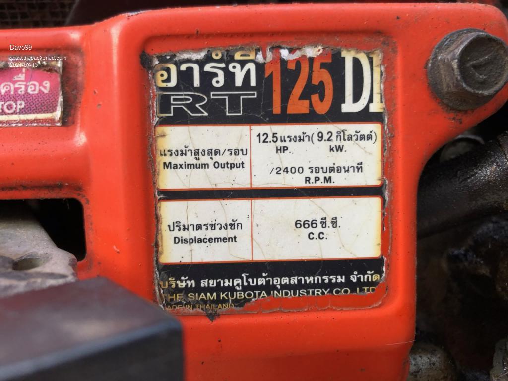

I did pick up a number of engines that were on fire pumps Some years back.  There is a 10 Hp aircooled Yanmar Single I have lined up now. Just need to organise  collection with the guy that has it and a friend to try and drag the heavy arse thing into my ute. I thing is is Seized though lack of use but being a 10 Hp, it's worth having a crack at getting going.  That one is a freebie to save the guy having it taken to scrap.  It still has the pump so that could be real fun If I could find a 2" hose and hook it up to an IBC. Might last a whole 30 Seconds! I think the pump is 4".
If I can get it going I might sell it. one of the farms round here might be interested.
A 16 Hp  WC would be good in that I could reduce the Revs and therefore the noise. A lot of people are under the misconception that Diesels have to be run hard. In industry, usually the opposite is true.
They are over sized and under worked for longevity.

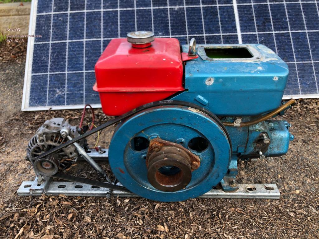

I bought a single cylinder 12Hp air cooled Wisconsin generator ($50 not going no carburetor) but the alternator was also stuffed. This was direct coupled and originally ran at 3,000 rpm, and was very noisy.
So what I did was hook it up to a tradmill motor with pulley drive, and now only run the Wisconsin at 1,000 rpm. That made a huge difference to the noise level, but its probably now only about 1.5Hp to 2Hp at that speed.
That is fine, 100v at around 8-10 amps dc is all I really need for slow charging a battery. Its only a 50Ah battery anyway.
This now also has a 60 amp car alternator, electric start, and a proper ignition system.
Just need to get a natural gas carburetor for it, but it runs fine now on petrol.
Its really all a pile of recycled junk, and cost almost nothing to put together, but pretty happy with how its all turned out.
Cheers,  Tony.

  Warpspeed said  I bought a single cylinder 12Hp air cooled Wisconsin generator ($50 not going no carburetor) but the alternator was also stuffed. This was direct coupled and originally ran at 3,000 rpm, and was very noisy.
The Wisconcin's are not a bad engine. I rebuilt one the year before last for a Ditchwitch my mate let run out of oil. I was surprised I didn't have any trouble getting parts for the thing. Pretty beefy engine for it's output  ( think his was an 18 from memory) and decently made... unlike some of the other US brands. Had real Bearings unlike some which run in the rod or block itself which is just aluminium.  the Crank polished up ok and I just honed the bore and Filed back some oversize rings to fit. Thing runs better than when mate got is as it wasn't too new then anyway.
Would also make a huge difference to the longevity of the engine as well.
One reason I like Diesels, most of them are flat out at 2200 RPM even though they sometimes sound as fast as a petrol but they have loads of torque and you can slow them down so they are quieter and less grating on the nerves. The lister is flat out at 600 Rpm and is a pleasant sound. Slow that down and it's like listening to a big clock ticking away.
As I sit here writing this, the Poo truck is over the road sucking out their Bog Tank  as they come every Thursday, Usually before 7 am. There is a Pump on that thing that makes an ungodly racket especially the time when he normally comes, screaming away  for about 20-30 Min and it is so damn noisy the whole road can hear it.  Lucky us to be right across the road from it!

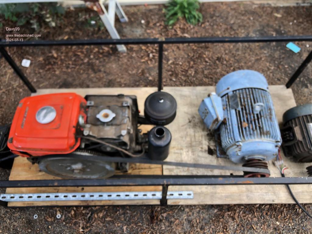

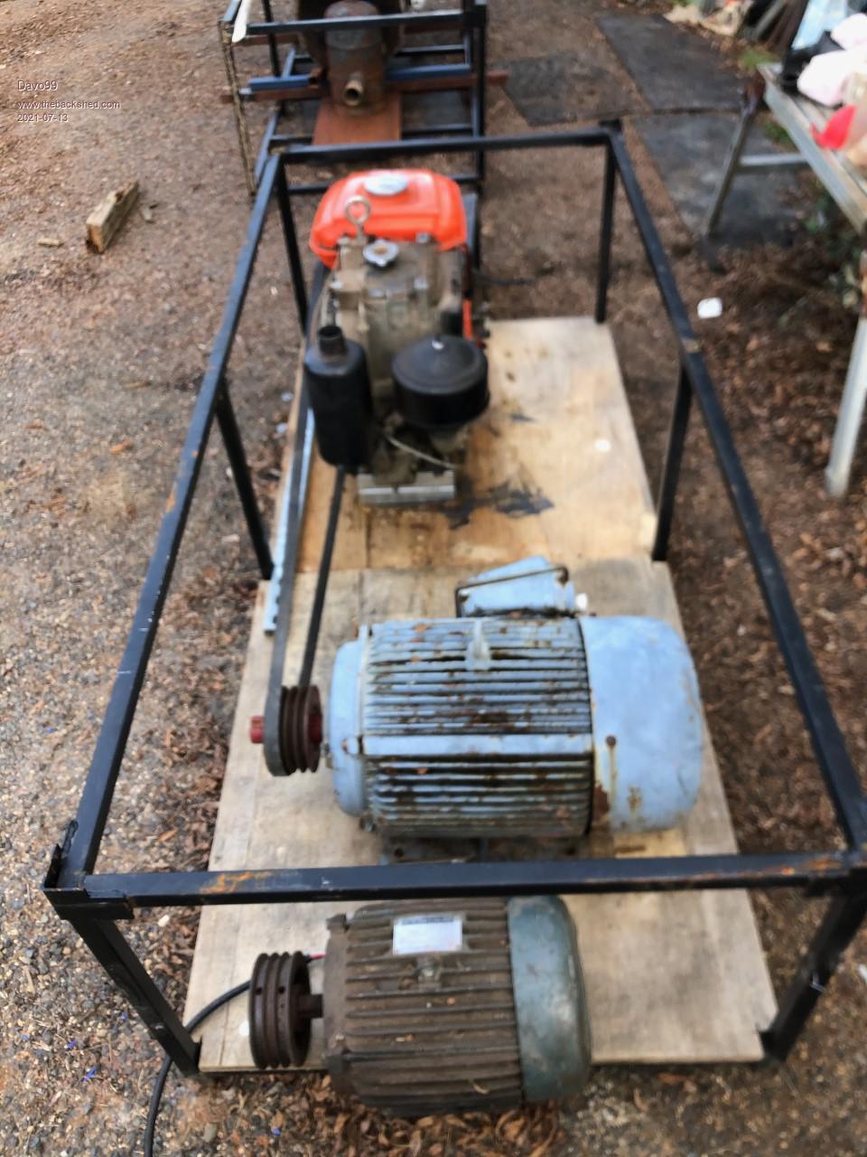

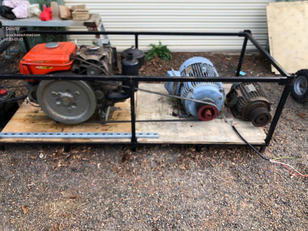

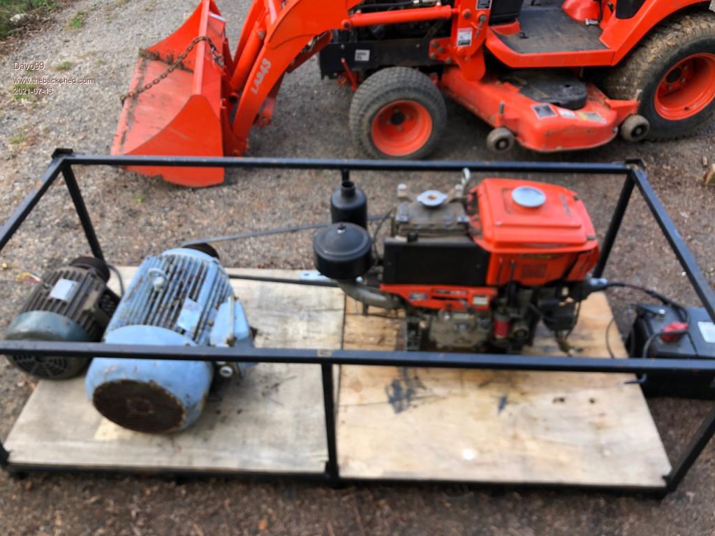

I might try and Drag my 12 Hp engine out today and see how it fits up in the racking I got. If that's OK I'll get out the big motor and try that then see how heavy it's all going to be.  I remembered there may be a 5 Hp up Diesel up there but can't remember if it's electric. Actually, Now I think of it, I believe it is but I seem to recall it's also an air cooled.  Bugger.  Spotted it buried the other day while Digging around. That will take some exhumation.  Also found an 8 Hp but that's Air cooled as well.
Think I should sell some of these and put the money towards an inline Kubota.
