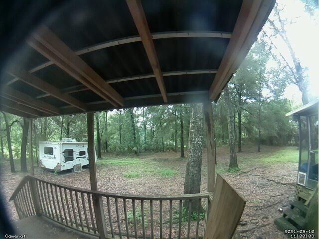

Not exactly what you are looking for, but I've been pleased with this setup of the MotionEye OS on raspberry pi--PiZWs, A, and 3B.
https://randomnerdtutorials.com/install-motioneyeos-on-raspberry-pi-surveillance-camera-system/
and https://randomnerdtutorials.com/cctv-raspberry-pi-based-system-storage-motioneyeos/
Through the pandemic they've allowed me to monitor my Florida snowbird home 2,000 miles away.
You can have local SD card storage, storage on a hub SD card, streaming, and remote capture (I have a cron job on a local-to-me PiZW which takes a snap every minute from 3 cameras). Various R-Pi cameras are available, including fisheye. I don't know whether there are R-Pi PTZ cameras.
