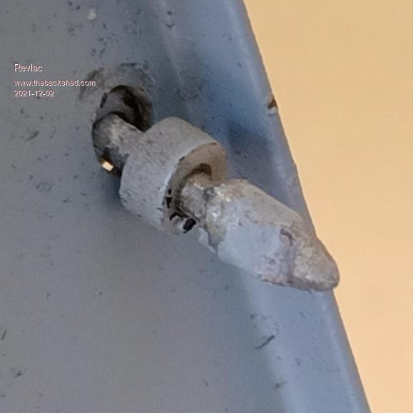

Think they are related to DZUS FASTENER or DZUS screws?
This is out of an Ericsson, has a rubber ring that stops the screw falling out, could use some small rubber fuel line, might do the job.

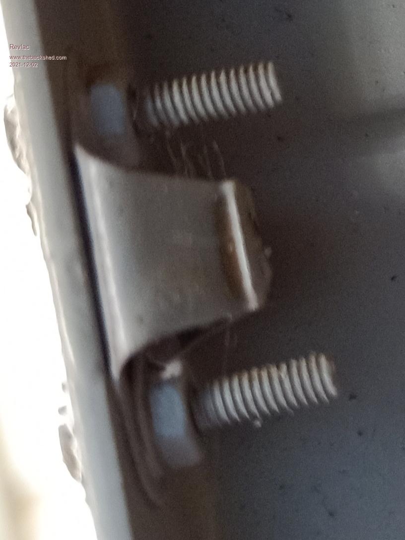

Inside the cabinet.

I thought you would know, .  I will cut a small piece of tube and slip it over the end..  I thought I may have misplaced whatever they had ,,, but thinking again --- maybe one ,,but not the 4 of them , so maybe there was nothing there.
