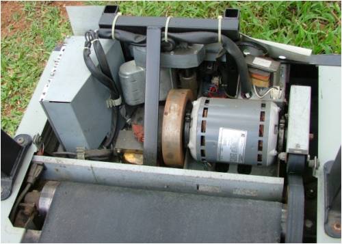

Below is the drive of the larger treadmill ( weights a tonne, just getting the thing off the trailer was a workout! ). AC induction motor, no HP or watt stamp. There's another motor in there on a jacking screw to tilt the treadmill up and down.

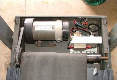

And this is the smaller one, DC motor 180v 1.25HP.

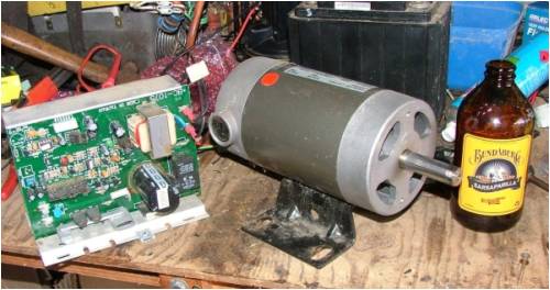

Here's the motor out of the treadmill. Removed the flywheel and fan. Shaft diameter is 16mm, casing is 105mm diameter and 180mm long. Two pole. Spin in the lathe shows 24v at 460rpm, so it should work ok on a 12v system.

The nameplate says 4000rpm, 180v, 1.25hp.
I managed to get it working with its controller, a resistor had gone open circuit. There is a opto-isolator I can feed with a PWM to control the motor speed, I'll put together a little 555 circuit with pot to drive it.
I'm thinking about making my own F&P test bed. The motor has a belt and 1:3 pulleys, so I'll fit the larger pulley to a F&P shaft to reduce the treadmill motor speed by 3. Add a pony brake, a couple of meters, and I'm off.
