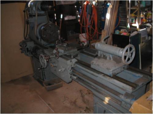

I recently purchased 3 phase metal turning belt driven lathe. If I measured correctly, it is a 16" X 74". By the look of the castings, I'm guessing it was made in the 1940's or 50's. Everything seems to be in great shape.
It has no name plate anywhere on it to tell me who manufactured it. Best guess, it's an old Warner Swayse.

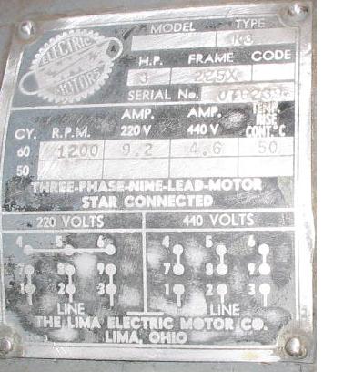

I purchased a Hitachi VFD drive to convert 240 split phase electricity to 3 phase. The instructions want to know how many poles the motor has. Does anyone know how to tell without taking it apart? Bryan 1 maybe?
Motor Specifications:
Lima Electric Motor Company
Lima, Ohio
Type R3
Frame 225X
Code 1
60 Hz
9.2 amps@220 volts
1200 RPM (has a gearbox mounted to the motor)
3 HP
3 phase
9 lead
star connected

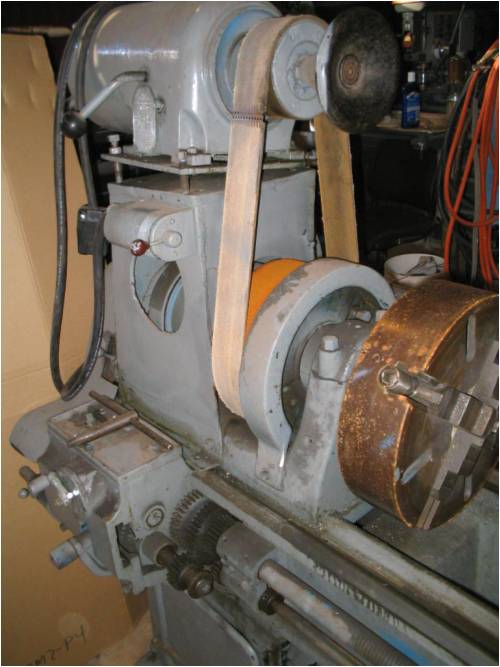

Here's a few pictures of the beast.

Short answer:
You have a 6 pole motor.
Long answer (teach a man to fish, as opposed to giving him a fish...):
For your American 60Hz grid frequency, number of poles = 7200/RPM = 7200/1200 = 6
For us Europeans (or anywhere else that uses 50Hz grid power), number of poles = 6000/RPM
Keep in mind that for VFD duty it's best to use VFD-rated motors, as the sharp pulses of the VFD PWM put larger stresses on the insulation than the 'gentle' sines that come out of the grid. Judging by the nameplate that motor is a little older so likely not VFD rated. Personally I wouldn't have trouble using it with a VFD, but keep in mind that it may suffer from a reduced lifetime because of lack of proper rating. Still, it's early enough to shop for a new (VFD-rated) motor when the present one fails, I suppose.

Because of the Bushings rather than bearings (I think), I'd add some maturity to the age guess.
