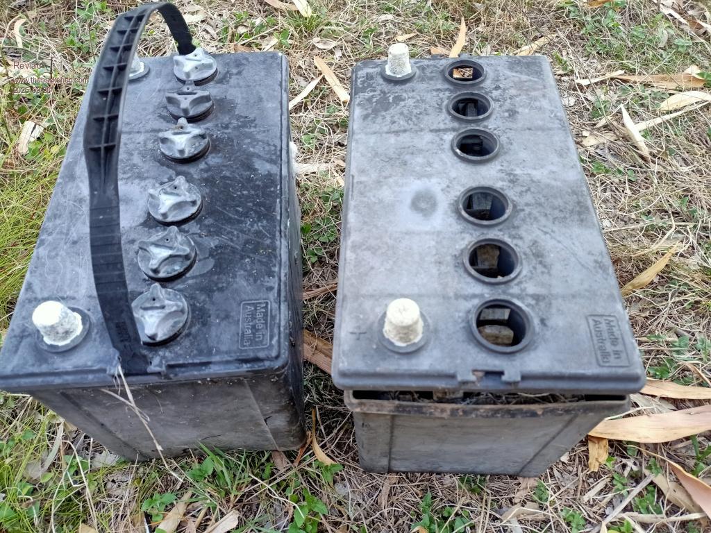

Some where usable at 15 years old, many where failing, all where stuffed at 20 years, that was 20 or more years ago, was very little interest in off grid usage back then never thought much of it.

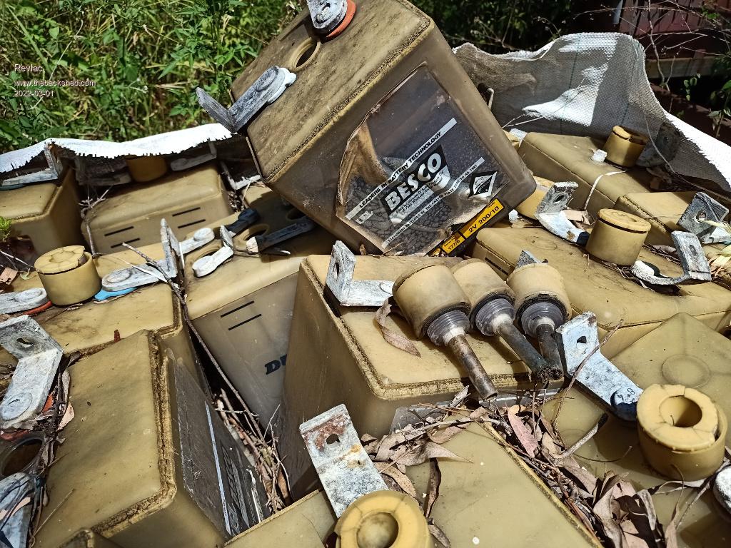

These are in the scrap pile, A lot of these had vent caps, some were plastic beads sort of moulded together, the others had some heavy stuff that looked a lot like those pink grit grinding stones, probably some help in keeping the water level up.

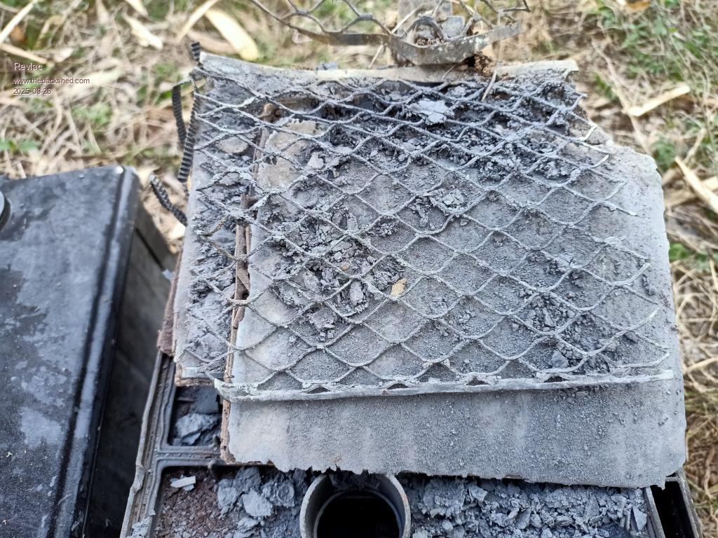

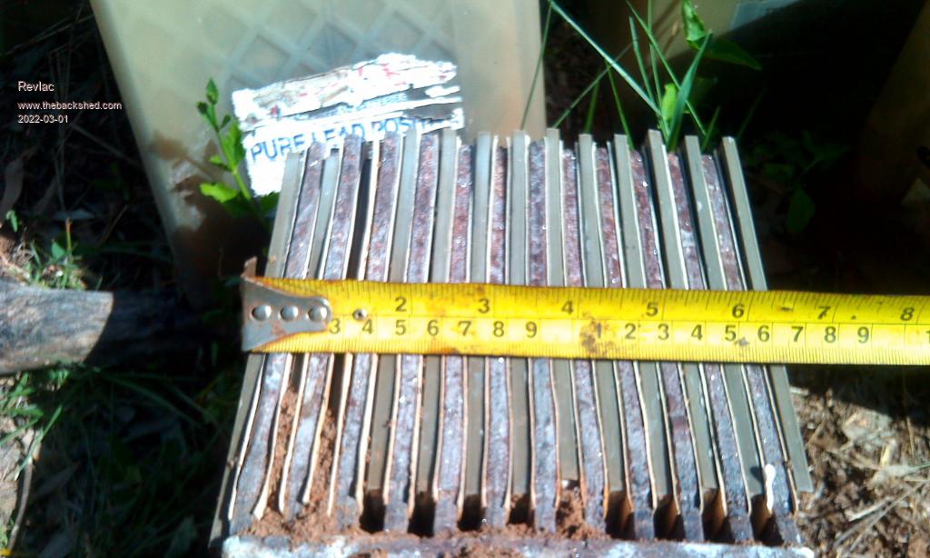

This is one of the 2v 200AH batteries with the case removed, being deep cycle rated, the plates are very thick and long lasting compared to the rest of the starting type batteries, that's the way it used to be.

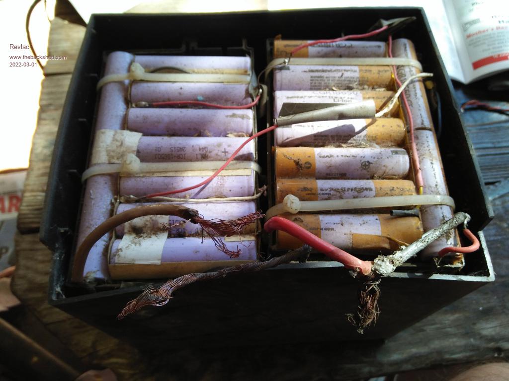

Started ripping the notebook batteries apart, some were quite difficult to open, used hammer and chisel to start a few off, removed the circuit board from the few I had opened up and checked each 18650 cell with a multimeter found a few of them still had a reasonable voltage, some were pretty much flat.
Was interested to try these as I had never had any lithium 18650 cells before, wired some up a 3s 2p for a 12v Hitachi cordless drill that previously had NiCad's in, put the cells inside the battery pack and wired the terminal up and tested it out, seemed ok, Charged them up, used it for a bit and give it to the old man to use, was quite happy with it.
Ended up running it till it went flat, it would suddenly die while in use, try in again a bit later and it would run again drill another hole and just suddenly die again, the NiCad's would slow down gradually in comparison.
Unknown to me at the time, I would have been driving a pair of the 18650 cells in reverse leading them to there death, strange that the cordless drill would just stop, (looking back now, it Didn't keep running and kill the 2 cells immediately), managed to get a fair bit of use from that battery.
I have run another motor with these and it kept running driving the cells in reverse and that killed them first time.
Continued removing cells from packs, found a few that had a substantial dent in the side of the cells, looking at the case found no damage or marks of any kind, so the damage to the cell's was there during installation (WTF was quality control doing when that went in?) somehow it still worked.

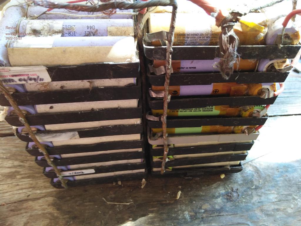

Took some time but got a substantial amount of cells to start experimenting with, tested and charged them all to 3.15V as that should be a safe margin, from the little research I had done.
I had A gut full of taking apart plastic battery packs, so a few days after each batch was charged I checked the voltage of each cell to see if there was any voltage drop, there were some, and they were put aside to deal with later.....this process took weeks.

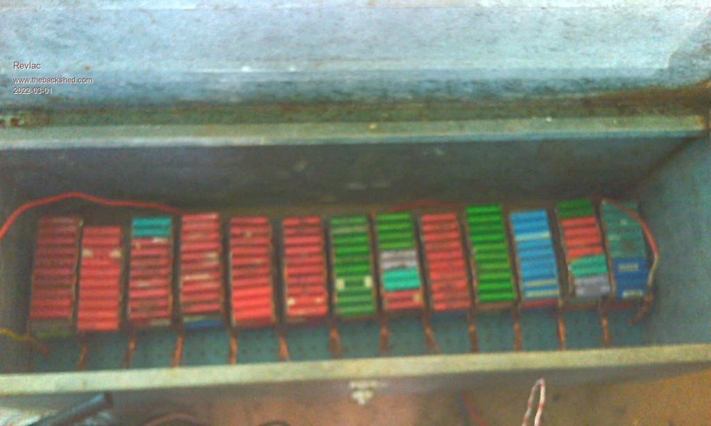

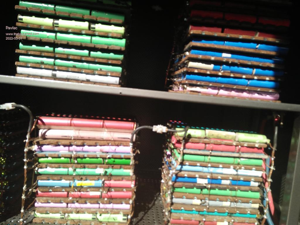

The ones that where holding charge, were arranged in groups of 10 and wired up and solder on to all the ends of the cells, some of the notebook batteries 3s 2p and 3s 3p charged and tested ok so wired them up as big slabs.
I think at the time to get 48v at about 180AH (using the 2AH average to go by) , 13S 90P and was tired of wiring all this stuff up, we were running the house off grid during the day with a set of 4wd batteries and a 4048HS inverter.
Old Man said "why not connect it to the inverter and run the house with it" I had no idea how it would go with balance over night or if it would burn up and be a disaster, But F*%#k it, worth a try.......Quite a surprise that it was ok in the morning.....2016.
It took a bit of time to learn its behaviour and tune the charger settings, bulk charge and float voltage was adjusted to be quite close, some cell balancing was required, just used a car head light to bring down the cells that were a little higher than the rest.
I did look into a BMS at the time but was not satisfied with what was available, so just checked the cell voltage each day almost at the end of the bulk charge stage, eventually found it to be good enough to do manual cell balancing almost every 2 weeks, these cells did not run away with high voltage when getting close to fully charged (could be just the way I configured it), leaving me plenty of time to any balancing, in comparison LiFePO4 cells do run away very quickly when close to fully charged (depending on users definition of fully charged voltage) it was going well and they were taking all the charge that was available from the solar panels installed at the time.
Over time I striped down some more battery packs did all the checks, charged them and made up another 48v battery bank, this was about half, more was added but seem to have lost the photo,  eventually increased the first lot to 100p and the other is 13S 90P in an old tool box..........2017 Plus A bit.
The youngest cell is built 2012 the others go back to about 2009
When charging these 18650 Lithium's 13s 100p and the other pack 13s 90p to 53.3v is 4.1V per cell, Then it will go to float 53.2 some might be 4V some as high as 4.13  my upper limit is 4.15, if any get to 4.15 then its time to take action and deal with it, (always had plenty of time to catch it) connect a car headlight to that cell until bulk charge has finished, I have also left the headlight connected to a cell group for the rest of the day (got distracted by some other job that needed doing) come back and the cell reads 4V, hasn't been a problem so far, for the few times this has happened.
The biggest annoyance with this is that it was 2 separate battery banks but still parallel at the end terminals, giving me 26 cell voltage checks to do.
They have done very well over the years Despite having the battery leads 3 meters long, over all the years that these have been running, about 8 or so cells have be discarded over the duration because they had a small internal short and  developed a little bit of heat above ambient, just replaced them with a few others that where laying about.

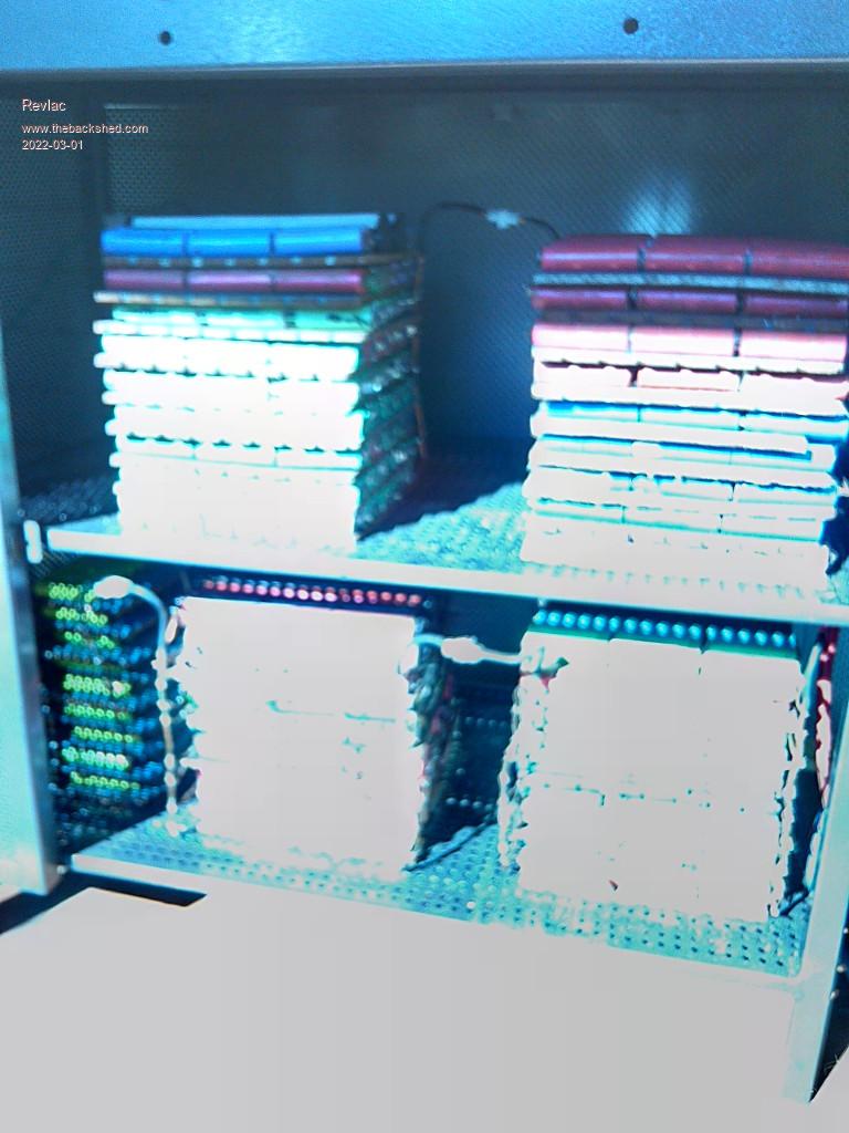

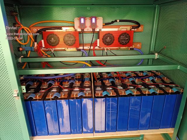

We put together one set of LiFePO4 cells to run and see how it works, run wires measure things up etc.
The battery terminals are laser welded in the shop (never seen that anywhere before) and done the way I want, there are some options.
Had to cover all the battery terminals so as not to drop a spanner or link bar across the cells, just wire up one at a time.
The cells (on the left 200AH) were configured in 2 rows and room for another set later on the right.
Did get another set later when they were on special, connected to a separate inverter/charger and separate house wiring, house was wired that way. My father is getting older and not as tolerable (aircon installed) to hot humid or cold weather, (and putting up with ME) he has earned and deserves to survive a little longer and have the place a bit more livable, overall usage over night is about 4 to 5Kwh.
I always learn more when doing the work myself, manufactures, products, quality control and personal experience quite often varies.

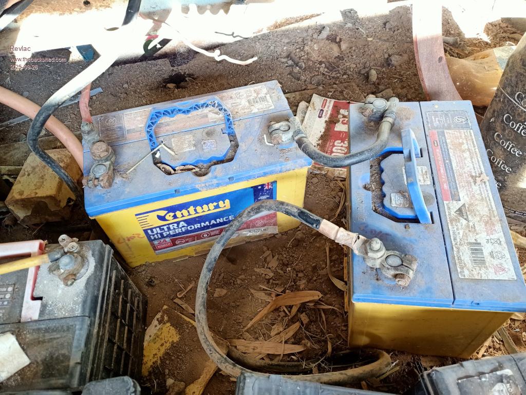

Time add a bit more user history, My Old Man has been buying and using Century batteries for longer than I can remember, When I was a lot younger we used to buy most of our century batters from the front gate at the factory Cobalt St, Carole Park, we lived not far from there back then so not a big deal to drop in any time.

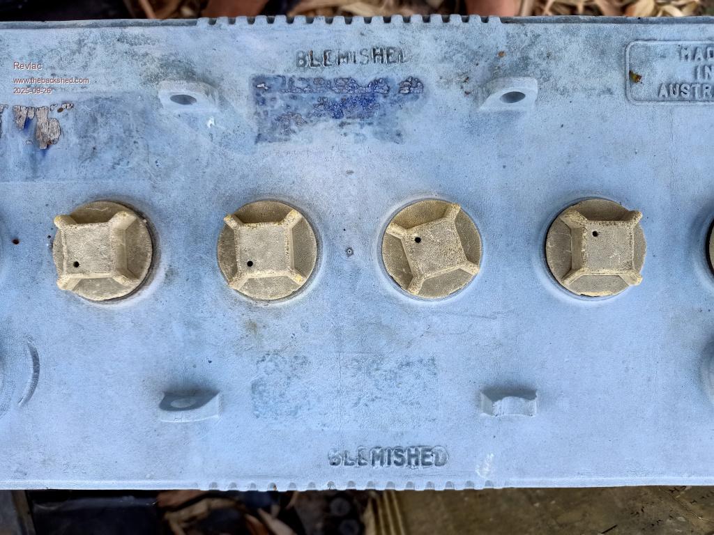

Mostly used to buy Blemished batteries, often nothing wrong with them, just a scratch or marks and a damaged sticker, we could get a good working battery at a reduced price.
For those that don't know what blemished looks like Have look,
One blemished battery was quite a bit of fun to use, it didn't pass QC because it had 2 large terminal post's instead of the normal POS and NEG post sizes, it was a good starting battery but when its needed in a different vehicle or tractor for starting it was a PITA as post was too big to fit NEG terminal....some swearing followed then opened the brass terminal clamp to fit the post, even more fun watching someone else borrow it.
When I was working in that area we had a fellow come in to get some work done, he was a Century employee that I used to do some welding work for, always well dressed chap and good to talk to, he worked for century for some time, good place to work no complaints.
The last Blemished Century battery I bought was about $40 but that was a long time ago, we did at one stage have a battery REP come (not sure which company he was from) into the Boat workshop with a new Marine Grade battery to show us the internal baffle design so there was less sloshing when used in small boats.
Moved from that area in 2002 and went an hour west, kept buying Century Batteries from local shops but no longer got the blemished batteries and so had to pay full retail, Had all ready started trying different brand batteries, bought our last century battery in 2018, think that went in the car.
Getting to the point, these 2 batteries are dated 2016 and 2017 and they are still working now.........
I will explain how and why because some people refuse to come clean with the usage history, these batteries have been used to start the big generator (engine only) and a 671 GM Diesel engine, and only do 3 to  4 starts PER YEAR and maintained with regular charging the rest of the time, they are very tired now and may have a few more starts still in them but not many, This is not good use of expensive batteries compared to those that are used most days several times a day.
If they were used for everyday normal use they would not last that many years.

Over the years and several tons of batteries,  I have opened probably close to 100 or so Lead batteries most of them deep cycle (melted them down) and were thick plate's as expected, The starting batteries   some of them were produced over the last 15 orso years with thinner and thinner plates, other people also noticed this too, While others Deny this is happening and simply don't know,  The worst one I have seen a few years back, (I lost the photo's) so taken another few photos now and removed a plate to show.
While these did start engines ok the batteries degraded much faster than others used in the same way and in the same equipment.
The plate resembles chicken mesh and the entire battery has very little lead in it that could be melted down to make lead weights etc, the only way to to get any lead value is to have it recycled in an industrial process.
Cheers Aaron
