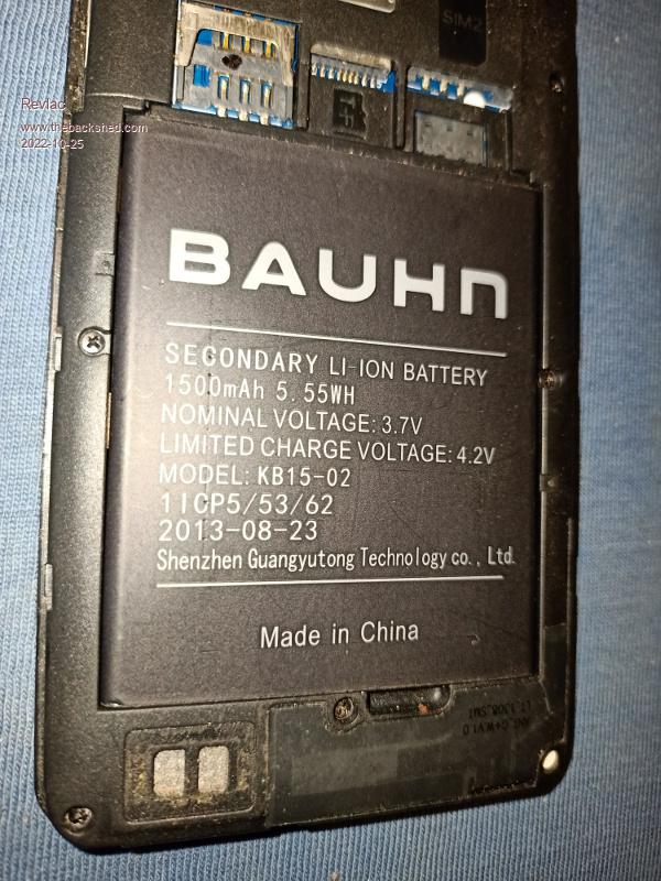

Bauhn asp-4300w
65 X 53 X 4mm
polarity, outer terminal is positive.
Modem battery is in use, cant find the old one ATM.
65 X 46 X ?4mm orso
I might have mentioned this someplace before, often a phone and its  battery is made and released on sale for a year, then until sold out, the batteries for them are made the next year after and then no more, batteries remain in stock until sold out and thats it.
I have bought batteries for OPPO phones and found them to be as old as the phone itself, so no chance of getting fresh new battery it will be old stock, this will be the same for some other brands.
So best of luck, you might be able to do some hackery to get a slightly over length battery to fit in.
Cheers Aaron
