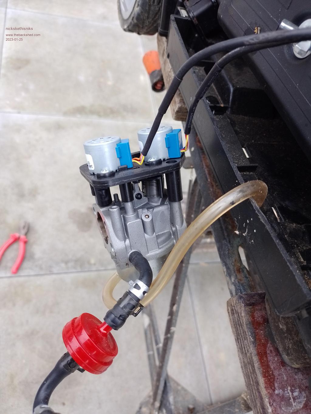

I also checked the stepper motors, the choke or inlet servo worked and blocked the entrance for maximum gasoline intake.
The other for the rpm/speed control did not move but I tried all sorts of positions.

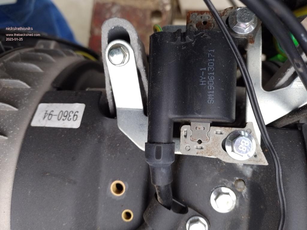

Although there are sparks, I suspect the ignition coil to be bad, the primary was about 1R (difficult to measure that low) and the secondary was 15K, if I explore google it should read more like 10K? So the coil might be bad, it might not be powerfull enough anymore to start the engine.
I think I don't here explosion so the gas is not igniting?
It's just freezing point (0-2°C) over here, I noticed the inverter needs more warming up time before I hit the switch. I could try to heat up the motor block to see if it's making a difference.
So I was searching for a new ignition coil but nothing found on that serial number.

Without before and after values ignition coil resistance doesn't tell you much, they can be 5k to 25k secondary and .5R to 5R primary. If you can get a spark length of 5mm or more at cranking speed for a non-CDI system it is probably ok. 10mm or more for a CDI.

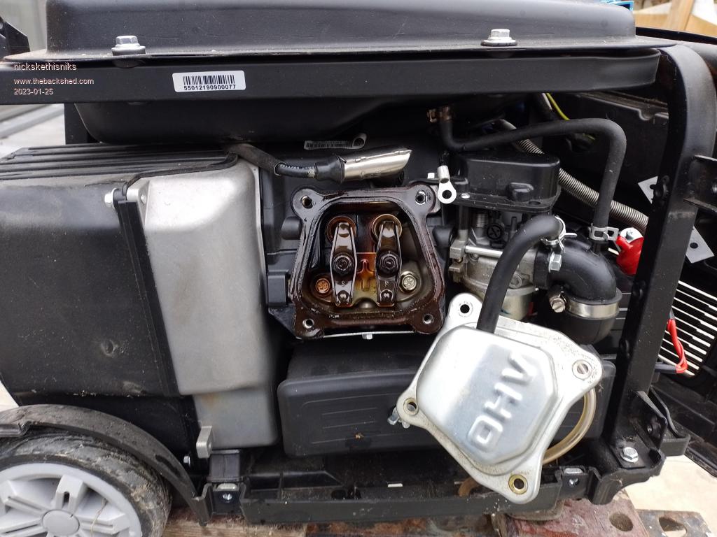

"how could I inspect the open valve, just looking?"
With the rocker cover removed (photo 2) crank the engine. You should see the valve stems (inside the springs) move in and out.
While you are waiting for the spray try squirting a little petrol into the carburetor and see if that works. Even WD40 may work if it is almost firing, but just needs a little extra flammable vapor.

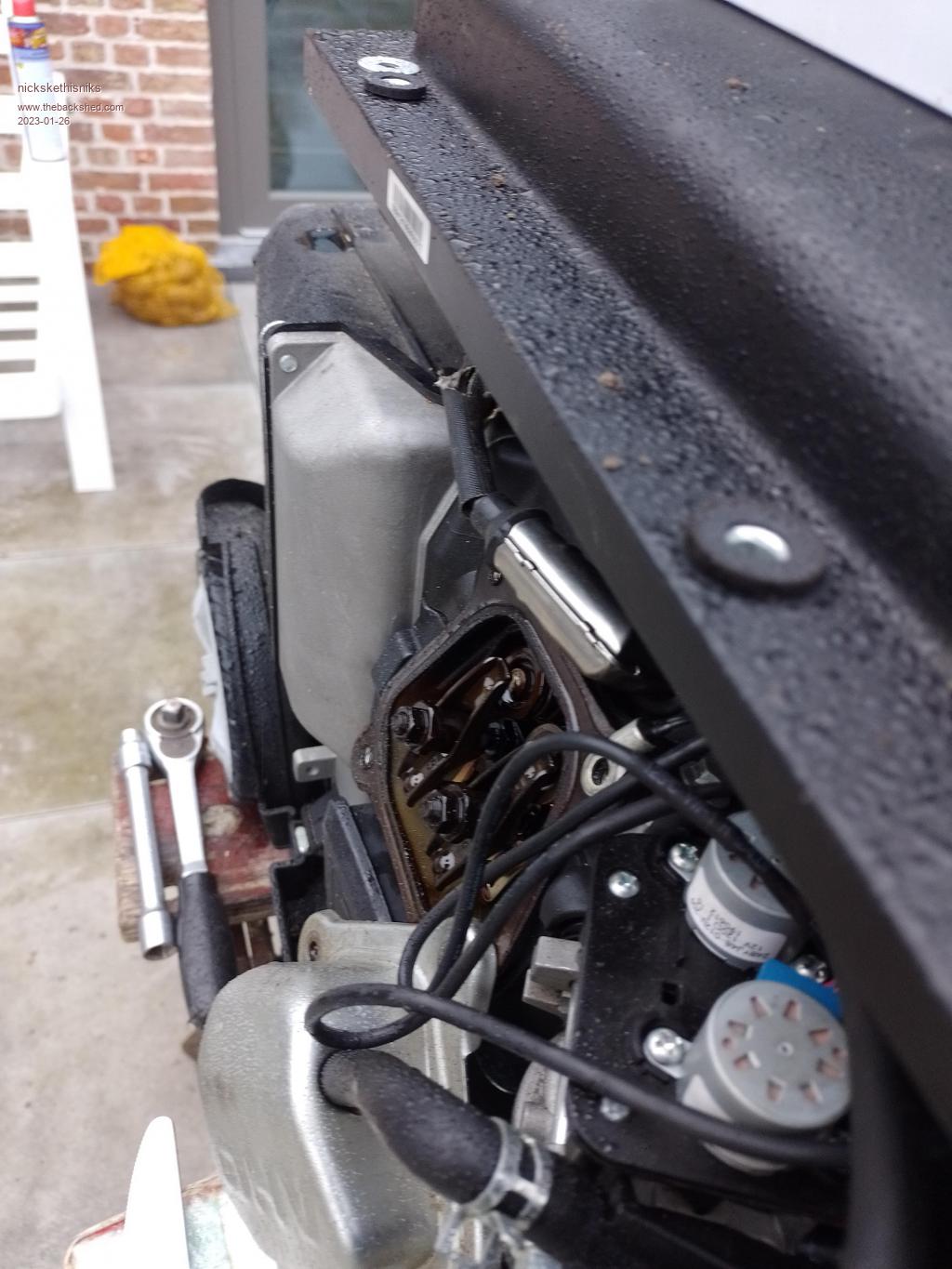

So I might found a problem, I checked the valves again during start up:
Something is stuck: sometimes it's normal but mostly not, so I assume one of the valves is not working correctly this way...
Can I assume this can be a major failure since it's not coming up?
I will try to upload a video.
Edit:
Ok, so I tried to move it a little bit by a soft hammer, but it's not moving fluently, I can move the small piston but it's going smoothly like the other one, the spring can't move the small piston by it's own.
What can/should I do next? Is it a lost cause?
Taking it all apart and then see further?
Edited 2023-01-26 19:28 by nickskethisniks

Looks like a stuck exhaust valve, usually they can get sticky and sometimes free up if wound over very fast with a fair bit of oil poured down the plug hole,  but a really stuck valve could be a different story.
A good soak in oil might help free it up, unless there is some other damage, hopefully the valve seat is not out of place, if it has an insert.

As Revlac wrote if the valve stem is binding in the valve guide it can be freed up with some lubricant (eg WD40 or similar) and working the valve back and forth or rotating it. Easier to do if you remove the rocker but when re-assembling the clearance between the rocker and valve must be set the same as the other valve. You will need a feeler gauge to measure it.
If you can push the valve in but it doesn't return all the way, stopping abruptly 4 mm or more short then the valve seat insert has probably come out of the head. (Note 1)
Repair will require removing the head, getting it machined and a new seat insert fitted.

Thanks guys, the wd40 everywhere trick for lubricating the valve cylinders worked.
I've got the unit working again at idle, I Will crank up the power this evening.

"How can I avoid it? So running the tank empty is a bad idea? Better to shut it of by the switch?
This is just speculation.
1) As it was running out of fuel there would have been a lot of extra oxygen in the exhaust producing oxides of nitrogen.
2) When the engine stopped the exhaust valve was open.
3) As the engine cooled the water vapour (note 1) in the exhaust condensed and reacted with the oxides of nitrogen producing droplets of acid that, with the remaining oxygen rusted the valve stem.
4) When you tried to start the engine the rust prevented the valve stem sliding back through the valve guide.
