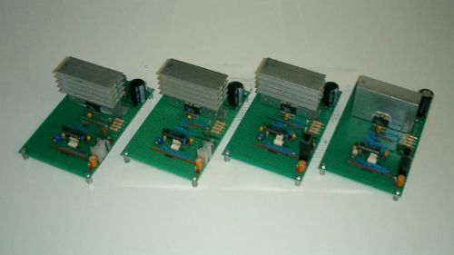

Anyway, reading about Glenn's (and other's) CNC projects on this site gave me the itch again. Decided to start with the (for me) easy part, the electronics controller.
It's a basic design around the L297 & L298 (schematic stolen from Glenn's projects files, but it's a straight copy from the L297 datasheet anyway; full and half steps, 2A per phase) with some very minor improvements as more/better reverse-polarity protection and adding plenty of LEDs to indicate status of the power lines and outputs. One can never have enough status indicators in complicated systems like this.
Decided to settle for 4 channels (I really wanted to go for 5, but I only had 4 each L297s and L298s in the parts bin; that, plus the cabinet didn't have enough room for 5 driver boards).

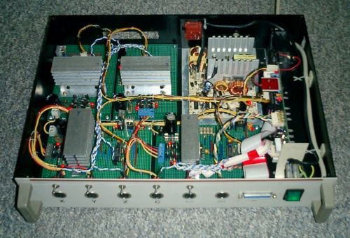

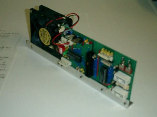

Threw together a simple interface circuit (straightforward, just a few 74HCT244 buffer ICs), some relay drivers and again plenty LEDs to indicate status of the various signal and power lines.

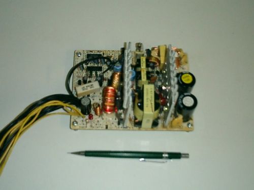

The power supply is (of course!) another Oztules-conversion job, a PC PSU modified to 24V/10A. But don't tell him... or he may want even more royalties.
All combined and wired up it starts looking like this:

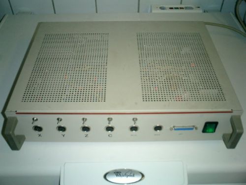

After final testing ready to box it up:

It passed all testing so far. Everything remains nice and cool (L298s, voltage regulators, computer power supply, etc.). The only things that get hot are the stepper motors themselves. Hot enough to cause burns.
