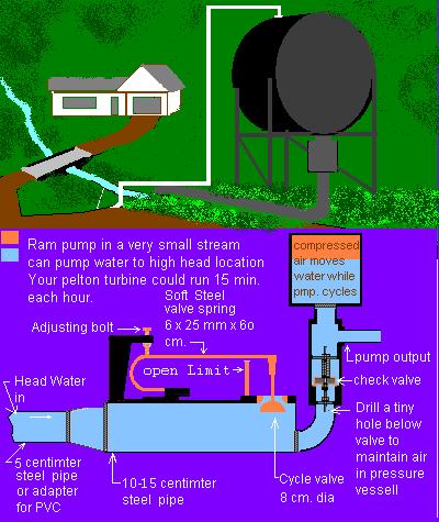

A ram pump My design but any is fine if it works.
another way to charge batteries

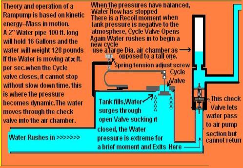

Interesting, but how does it work ?
What makes the "cycle valve" move?
I assume this has to be just at the right depth, can you indicate where the stream water level would be?

The Ram pump is very well named,Water is allowed to gain momentum and then suddenly it has nowhere to go, this Inertia generates high pressure for a moment.
I have drawn a operational diagram, hope this helpsjavascript:AddSmileyIcon

The Rampump is generally set up on the creek bank. a 2- 3
meter drop in the lead in pipe will make a good setup. should have a minimum of 60 feet lead in , this assures a
good mass of water in motion. you can google for lots of
info.

The flexiblity of this device is amazing. If you have a stream with plenty of water but only 1.5
meter
head within your property then a 15 CM. lead in pipe with pump valves to match could give you
5 meters of head (guess) and lots of water. Below is a link to, a build it yourself instructable,
This one is small but obviously does a big job well, also cheap.

The pump cycles about once per second. An average size pump will output 1/2 liter each cycle, depending on the pressure head and length of the lead in pipe. There are 86400 seconds in one day, That is 86400 / 2 = 43200 liters of water. = 10800 gallons and deposited as high as 30 meters above the stream it came from. Economy don't get better than this.! How does it work.?
Imagine a 2" diameter X 60 feet long solid steel bar moving along peacefully at 1 meter per second ,Bang ! hits A BRICK wall, Now think of this as a rod of water not nearly as heavy but still a non compressible solid.
The cycle starts with the cycle valve open, this gives freedom to the water in the lead in pipe. The Head water on a downhill slope accelerates, the light spring tension on the cycle valve can no longer hold it open as water surges through the limited opening.
The valve slams shut (brick wall) there is 60 feet of moving water in the pipe that must stop instantly, aint gonna happen, the pump has another valve that is spring loaded closed, The CHECK VALVE, when the cycle valve slams shut the instant pressure rise opens the
check valve and water surges into a temporary receiver where trapped air will compress and cushion the pressure shock wave.
When system pressure and ram pressure have balanced, The check valve closes, The compressed air moves the water on
to its destination and the water lead in pipe recoils slightly, creating a moment of pressure below atmospheric value, this permits the cycle valve to open with a little help from the adjustable tension spring. the pump is now configured to start a new cycle.
