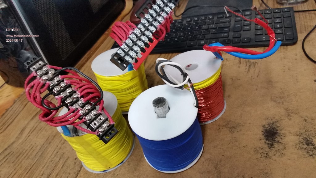

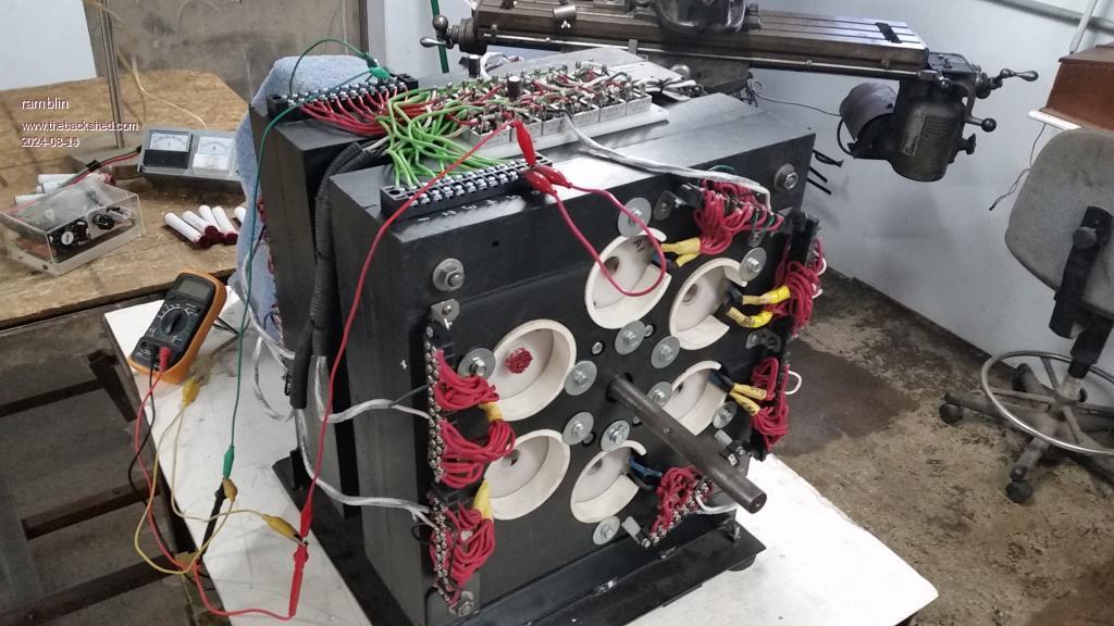

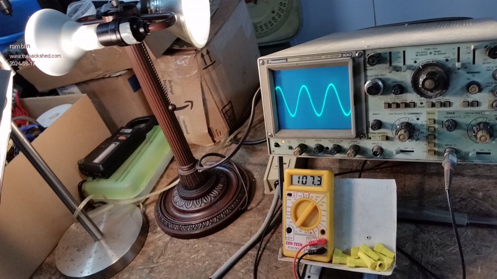

Maybe a few pics will help. Here 2 coils are connected as you describe and the resulting output and scope shot. Load is 195 watts. Also a few types of coils I use. Doubt you can see the settings on the scope but were approx. 550Hz.

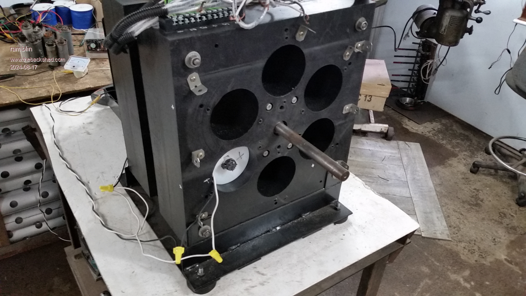

Sorry for the delay... We been having some internet problems . Try these..

What material are the coil cores made of?
If solid iron the efficiency will be low, if powdered iron the cross-section seems too small compared to the diameter of the coil.
There doesn't appear to be a laminated iron yoke to complete the magnetic circuit between the free ends of the cores.
Conventional generator designs are the result of almost 150 years scientific research and engineering development by many thousands of people. This has resulted in reliable, predictable and energy efficient machines (98.7% for the biggest ones).
I think it will be difficult to achieve stability and efficiency with this design.

You are correct, iron is not efficient and causes a lot of drag. Core material is what we have researched the most and is a key factor. I have experimented with the iron yoke with little results on this machine. It played a larger roll in my early designs when rotor mags were all N on one side and S on the other. Now you are correct, stability has always been a big issue to overcome. Efficiency, however, I would argue can be very high. Conventional it is not and one of the reasons I picked up the project. Neo mags are remarkable things and are becoming stronger and more affordable. Many experimenters are playing with smaller, slower versions of this and having great results. I`m told this is has been employed in experimental windmills (might be why I see so many burn to the ground). I thought this project might be of some interest to the windmill guys here. My biggest issue lately has been combining the inputs and getting all the available amp out of it. Really need some guidance there.

maybe I dont understand what you are trying to do
Looking at the photos I can see a shaft
I assume inside the box is a disc with magnets attached
If this is correct and you connect all the coils in series the induced currents will all be out of phase'
re 2nd para If you have two coils in the machine and they are correctly polarised you will get 120 v on each ie 240 v but still 4 amps
When you put the other 4 coils in the machine you will get the same voltages but out of phase by 120 deg each This does not matter when you rectify the 3 outputs
I am surprised that you get 4 amps as the magnetic field is not closed.
If you look inside any induction motor or alternator you will see that the stator has a magnetic core and so has the rotor and a small air gap between the two .
To get this to work you need to close the magnetic path to approx 1 mm
If you try mild steel you will have a lot of losses due to eddy currents generated by the ac and put a lot of load on the driver . In motors and generators the magnetic field comprise of laminations of electrical steel. these are 12 thou thick and insulated on each surface to block eddy currents
