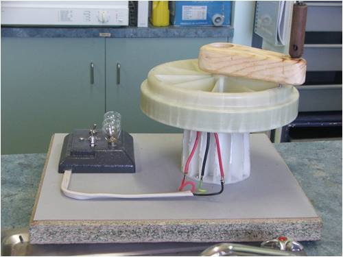

I’ve recently made a couple of hand cranked F&P alternators as demo units for the school science labs (where I work as a Labbie). They have proven to be extremely effective in demonstrating energy conversion and alternator/generator principles in the science curriculum.

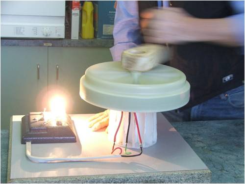

The students (and teachers) have been surprised how much effort is required to produce around 100w to light the lamps and it gives a good appreciation of energy ‘production’.

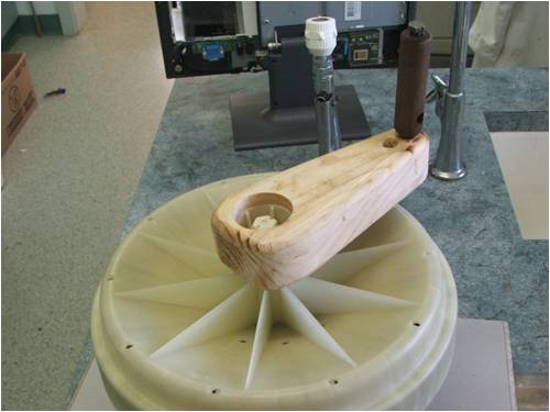

To mount the F&P motor on the heavy particle board base, I cut the bearing hub out of the plastic tub using a reciprocating saw, keeping a fairly large radius to act as a mounting flange. The steel shaft was cut by hand with a hacksaw just below the rib near its centre and re-fitted to the bearings before screwing it to the base board.
The stator was re-fitted after re-wiring it for 12v as per the instructions on this website.
IMPORTANT : I WOULD NOT RECOMMEND USING THE STATOR WITH THE STANDARD WIRING CONFIG AS IT IS CAPABLE OF PRODUCING LETHAL VOLTAGES.
The crank handle was cut from a short length of 90 x 45 pine with a 42mm hole cut in one end using a hole saw. This proved to be a tight fit over the slightly ground down plastic nut on the motor. A long wood screw near the outer end of the arm into the rotor helps to stop it slipping when turned. A long 6mm bolt and piece of drilled broom handle finished the job.

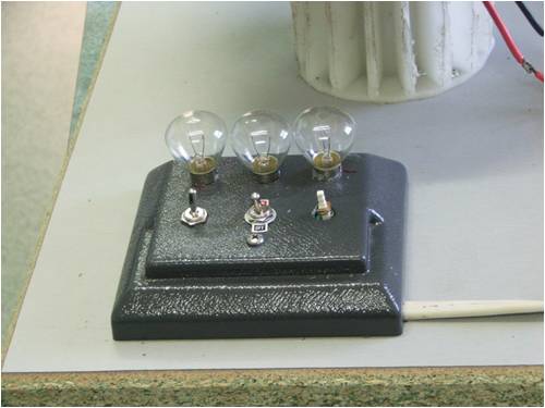

Each of the 3 output phases was connected through a toggle switch to a 12v 35w lamp mounted on the baseboard. This way the load can be progressively increased while turning the handle. It takes quite a bit of effort to fully light the 3 lamps.
When time permits I hope to add bridge rectifiers and meters (V & A) to enable calculation of power output.
Will try to upload some images soon.

I have checked the no load AC voltage output and it hasn't gone up much over 18v, even with fast cranking so I reckon its fairly safe.
Have also checked the output under load and it has been possible to get to 12 volts but VERY hard work with all 3 lamps switched in and not sustainable for long. I am also building a wind turbine and this generator has given me a good 'feel' for how hard the blades have to turn to produce power.
