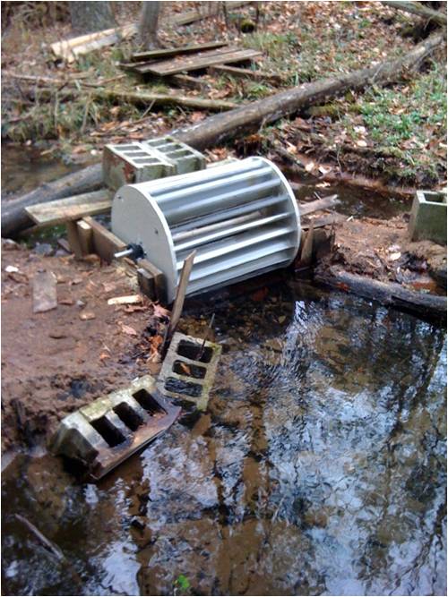

If you have a lot of drop and a little water you have a good start. You could try making a water wheel about as tall as you as your drop. The bigger the wheel you can make the more torque it will have, the water will be able to fill more reservoirs and they will be further from the center. Think of holding something close to your body then trying to hold the same thing at the end of a stick six feet long. If you don't have a lot of water you will want to keep it narrow and channel the water to it. The wheel will be more efficient if you can make it so that it will hold water until the revolution causes it to spill out. I have seen one online somewhere one made from small plastic reusable food containers. I also have a small creek that I’ve been trying to make electric from. It never dries up and never freezes, but I have very little drop and the banks are very far apart. I made a wheel that turns from the current of the creek. Because the diameter of the wheel is small and I have very little drop it doesn’t have much torque. I am thinking of going with something like a Kaplan turbine. I’m wondering if I even have enough drop for that.

From what you are saying about the width of your creek, I gather that it would be difficult to dam it completely which would let you use a kaplan turbine (or several of these side by side) to best effect.
If this is so, then you are probably best off scaling up your paddle wheel (which looks good in the photo) to be as big as you can make it. As you indicate, the larger the diameter, the greater the torque that you will get. It would also be true to say that the larger the submerged paddle area, the greater the torque for a given wheel diameter and stream flow.
Unfortunately though, the larger the wheel diameter, the slower it will turn for a given stream speed. Power is a function of torque multiplied by speed, so that there is a down side to slow rotation.
This did not stop factory owners in days of yore from diverting streams (or some part of a river flow) through a channel, and having a series of paddle wheels of 3 metres or so diameter just dipping into the channel and driving grinding mills , etc . Several of these wheels are still operating in France today, although most do no useful work except for attracting tourists (Ille sur la Sorque, Avignon, etc).
There is an actual operating wheel in a paper mill in France at a place called Fontaines de Vaucluse, still with its original wooden gears, etc. Fascinating, but high maintenance. I think that you would be better to stick to modern gearing if you want to make useful power.

Thanks for the reply Don. You are right on about it being difficult to dam. The banks are about 30 to 50 meters apart, and the ground on each side of the creek is loaded with trees and swampy. I will post an overview picture of the creek showing the banks on each side. The latest attempt with the wheel installed is giving me about 4 inches of drop behind the wheel. Another idea I’m thinking about is using pipe or drain tiles with propellers installed similar to a Kaplin style turbine. I can control the flow of the water as long as I don’t try to dam it too much. If the pressure ahead of the dam is too great the forces its way around the dam in an area that is very hard to plug off. This is a project I really can’t wait to get started on again this spring. Being that there is a large amount of water that flows 24 hours a day there is good potential to create electricity. Doing so on a low budget makes doing so more challenging. Oh here is another thing I’ve read a little about online, using the flow of the creek to operate a ram pump. Pumping water to an elevated height to spill into a tall narrow Palton style wheel.
