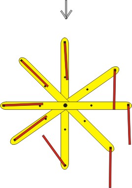

I disagree with your comment about the vawt in water, it will work the same as used in wind.
However I have this plan a design which will improve efficiency

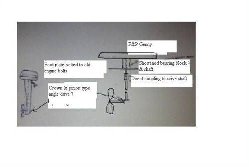

Have you thought of using an old outboard with the motor removed & replaced by a F&P.
The F&P could be housed inside the motor cowling attached to a footplate & direct coupled to the old drive shaft through the angle drive to the prop, you may have to up size the prop.
Just a thought, sorry about the rough drawing.
Barry

beaul
Joined: 28/12/2009
Posts: 4
Posted: 10:16pm 30 Dec 2009
Thank you guys for all your comments.
I have looked at the bobbing wave system Salter duck for example but again waves are not consistant in an anchorage. We try to anchor where there are no waves.
I do like the old outboard motor concept.

  beaul said   I disagree with your comment about the vawt in water, it will work the same as used in wind.
Thanks for enlightening me, I have yet to see a VAWT with movable vanes like your design. I simply assumed you planned to use a fixed vane design .

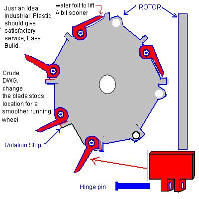

Greenbelt
Joined: 11/01/2009
Posts: 566
Posted: 11:58pm 01 Jan 2010
Beaul;
Look at this.
taken from one of my old scratch pads, very similar to the
drawing you posted. may be useful.
