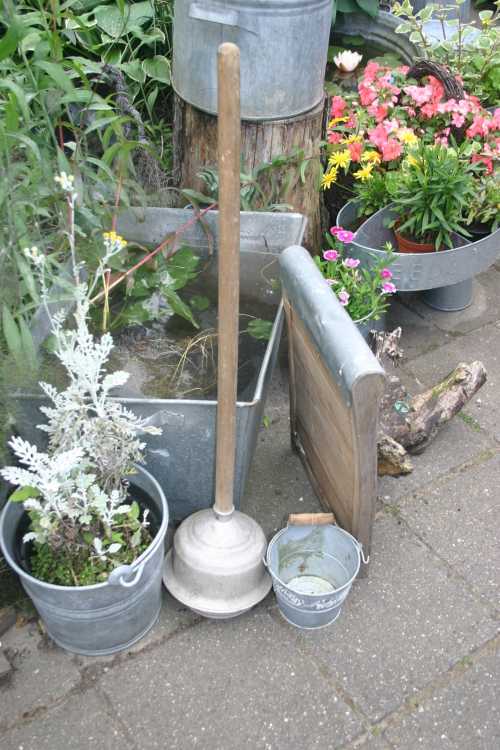

You need one of these:
(called 'wasstamper' in Dutch - no idea of the correct English word)
I have one, and they work surprizingly well. They work even better when you have one of these as well:
(doesn't need to be blond, other models may work too).
What RV'ers over here often do: put the clothes in a bucket with lid; fill with water and detergent. Put on top of camper, go for a ride. The heating action of the sun, combined with the movement of the camper, do the washing. When at destination, rinse and dry.
Peter. (<-- denies all accusations of the Dutch being cheap and stingy)

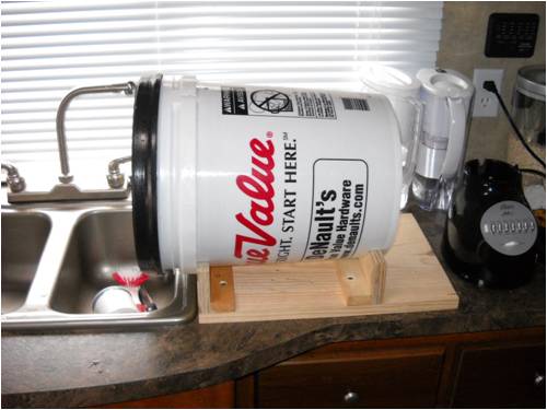

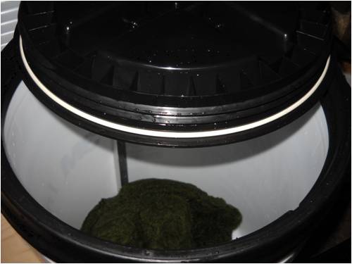

Anyway, I'm finally living my dream. I'm permanently set up in my trailer with the intentiion of "camping out" for the rest of this adventure (life). I tossed up something along these lines elsewher on the 4m, but I thought it best to start and end on the same thread, so here's what I've done:
I'm using a plastic 5-gallon bucket with a "Gamma" lid. The lid snaps to the top of the pail and has a rather large screw-on secondary lid, which the manufacturer "guarantees" won't leak. It leaks. That's not a big deal for me, I just worked around the problem and use it so the lid hangs over the inside edge of my kitchen sink, with the bulk of the rest of things sitting on top of the countertop alongside:
You'll see I've used a "cradle" to support the pail. Originally, I used my little lathe and built some long rollers using Delrin plastic bushings and some 3/4" copper as a tube. That worked, but it bound up every now and again, so I went to something simpler. The cradle is made of plywood and pine and is screwed together. I counter-sunk all the screw heads and ground off the screw ends on the underside so as not to snag anything or scratch my brand new countertop.
Here's a shot of the Gamma lid situation:
Each portion of the lid has its own O-ring to seal most of the water inside.

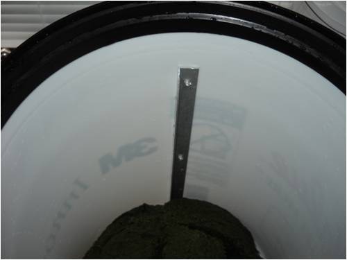

Here's a shot of the inside of the tub showing two small, aluminum paddles (angle stock) which I riveted through the outside of the bucket and sealed with clear silicon caulking. These snag the clothes and then drop them when the whole rig is rotated in the cradle and that action helps move the water through the garments much the same as a commercial front-loading clothes washer does.

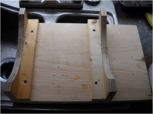

This shows the bare wooden cradle. Note that one side is flush with the edge. I did this to enable the end that leaks to hang over my sink so the drip goes into the kitchen sink drain and not on the floor.

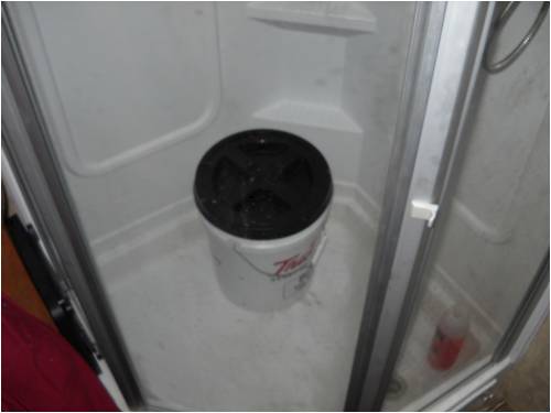

All I do is put as many articles of clothing I want to wash up to about half full (dry) and add water to cover. I actually usually put the water in first, add the detergent and make sure it's all mixed evenly, then dump in the dirty clothes and screw on the Gamma lid. Next, I lay the thing in the cradle and roll it about ten times each way, then dump the water and do three rinse cycles. After that, I run the wet clothes through a wringer, which is down the street at the car wash, then I hang stuff out to dry. I'm in the process of purchasing my own wringer, but the silly things are over a hundred dollars, so I'm taking my time. So far, nobody at the car wash has told me to get out, but being 6'6" and about 250 pounds may have a lot to do with that. Still, I'd rather have my own.
Finally, since "camping out" is kind of a head game when it comes to "living space" I use the washer for double duty. I use it as a little "stool" or "chair" in my shower. There's not enough room for a Shrek-sized fellow to bend over and wash toes and feet, so a stool comes in mighty handy. Also, sometimes I just let laundry sit for a day inside in the detergent to "soak".
That's about it for the washer. It's not 12-volt, but it works nonetheless. Next up is an active solar clothes dryer. I know everyone is automatically thinking "clothesline" but it's not that. This will be a cabinet that collects sunlight and turns that into active heated air movement. The articles of clothing will hang inside with access through a door at the rear. I've already expirimented around a bit and have the design worked out. All I have to do now is build it. When it's flyin' I'll post it here.
