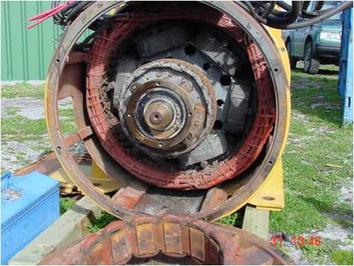

There are a few tons available in one of these if you stumble on one in your travels..... theres one outside my door actually.......
Microwave oven transformers are useful for laminates. Should be plenty of these available over there.
You need to be decent grade poor conducting steel to get the eddy currents down to reasonable levels.
