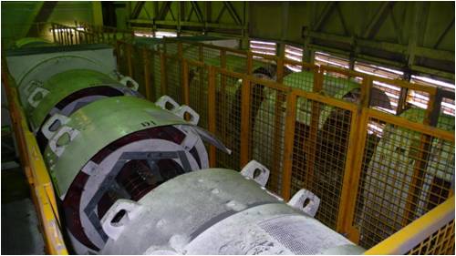

These are MG-Sets , might be a bit big for what you want , they are used to convert AC to DC for 33,000 ton Draglines that I work on .
