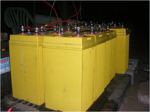

Chris, How about a picture of your batteries, looking down on the top of 'em?
I would think 'fixing' a wet battery's inside is well beyond DIY range.

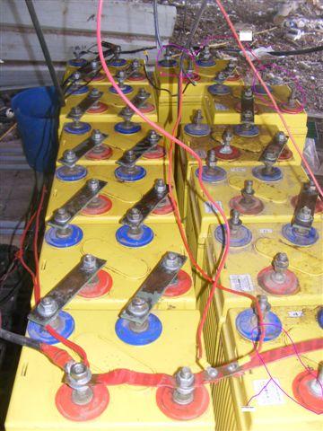

these are mine, note the parallel strings have bars across so nothing should get too out of balance
battery interconnects 2 strings 48V
Looks like batts are externally in good nick, perhaps an expensive mistakeEdited by KarlJ 2010-04-05

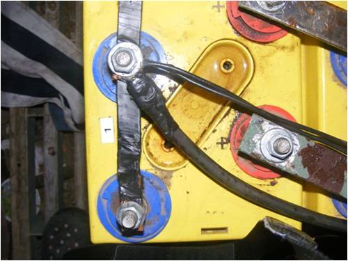

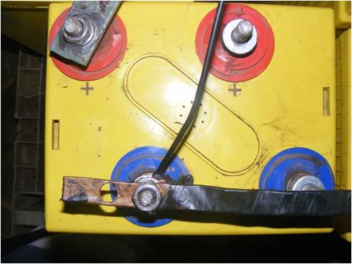

ps. here is the photo of how i have the batteries hooked up

I think you will need to read the plasmatronics manual, on how to set the various parameters. It is available online, if you don't have a paper copy.
You should spend a little more time framing your photo, to give all the connections. We still have to guess how it is wired. The lack of cell interconnects will resusult in potential for cell imbalance, with poor connections in a series string.
This is a 12V setup, so is really only good for a max 300-500W, given the wiring you have shown.
Gordon.
PS: If you think over a 1000W is possible, then you would need the inverter right next to the battery, and it is not shown that way.
