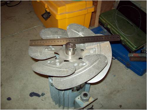

Posted: 04:53am 19 Aug 2010
Here's a pic of the fan I want to use as an impeller. It is out of a refrigerated container, so anyone around the world wanting to try this should be able to find one, and for being made for a marine environment, it is corrosion-proof. To use as a kaplan runner, it will need a streamlined housing around the boss top and bottom, fitting just inside the inner edge of the blades - this deflects all the water flow onto the blades and will also help support the blades.
Mac, while your fin-around-tube-inside-tube idea will work (just like the old towed ship's log) the relatively large surface area of the tube will reduce its efficiency. The kaplan uses exactly the same principle, just with more, shorter fins.
I have measured the pitch of the fan (22.5 degrees), and I estimate that my fan might rotate at around 80RPM, allowing for 50% slip - it is just a simple calc, speed of flow through the net area of the fan (1m/sec), divided by the advance of the fan per rev (.36m/rev) x 0.5 (arbitrary fudge-factor). The amount of slip depends upon how heavily loaded the fan is - with no load, the slip will drop to practically nothing and the fan would spin at maybe 250RPM. Any engineering types out there feel free to point out any flaws in my logic, please?
I can hardly wait for summer to get here so I can start building it without freezing to death - the creek is fed by a spring coming from the bowels of the earth, and is always about 10 degrees C

Robb
Joined: 01/08/2007
Posts: 221
Posted: 05:26am 19 Aug 2010
The density of water is much greater than air. If you have a worth wile head (enough to drive a F&P) that fan will be bent scrap metal in seconds Think boat prop with strong thick blades and the outer section of the blade cut off. Note the streamlined shaft too.

Posted: 07:09am 19 Aug 2010
[Quote=Woodsworks] . . . the relatively large surface area of the tube will reduce its efficiency.
I don't think you're going to get a heck of a lot of power out of this thing any way you do it, but if drag is a concern, make the inner, fluted tube more buoyant so it floats more on top of the water flow, with the escaping current turning against fairly deep fin(s) in the water. I'd make maybe 3 fins to wrap around the thing, so there was at least one full fin (between three total) in the water at one time.
If your fan doesn't get bent to heck right out of the chute, I bet it catches weeds and stuff, whereas my design would let debris slip by. Of course, if the water from this spring is pristine, bottle it! You'd likely make enough selling it on to pay for mains electricity!
. . . . . Mac
Copeville, Texas

Posted: 09:23am 19 Aug 2010
Don't worry, I am quite prepared to write off the fan testing the concept. I've worked on designs for 200-tonne towing winches for deep-ocean tugboats that the operators kept bending/breaking....8-inch shaft: bent it lots....10-inch shaft: bent it quite a bit....12-inch shaft: didn't bend the shaft but tore the winch off the deck instead :D The fan blades are only 1.6mm alli so I'm not expecting much of them. It's no biggie if they bend downward, just so long as they don't break right off.
The intake will have a grille to keep the flotsam out, angled to the flow so it will be self-clearing. It's amazing how much plant matter washes/blows into the creek.
I just want something cheap and nasty at this stage to get an idea of how much power I might get. I don't need to fit an F&P motor straight away, I have a huge collection of largish stepper motors to choose from, which I can add one by one (Wow, variable load!). It may well turn out that this is all the turbine will run (especially if the blades bend over!). The next iteration, if it gets that far, will be a purpose-built runner with decent thick blades.

SSW_squall
Joined: 20/03/2010
Posts: 111
Posted: 11:36am 19 Aug 2010
G'day woody,
Couple of comments:
I think i confidently state that the fan you've got there is not suitable, firstly the diameter is too big, secondly the blades are too shallow in pitch for there length and lastly it wouldn't be strong enough...
The flow through this 10" - 12" sized kaplan machine would be in the order of 250L/s at a head of 1-2m.
Strongly recommend you read this article, which is a good read:
MICRO HYDRO ARTICLE
Importantly this outlines the pitfalls and successes of a setting micro hydro rig.
The machine featured is the Energy systems and designs low head machine, find it here:
LOW HEAD MACHINE
Also have a look at the FRENCH RIVER LAND website for there rebuild of a hydrolec tube turbine for info on a comercial scale unit
If you check out the graph at approx 1m head it will be using about 35L/s and generating 150W. This machine has a 5" impeller so you can get a good idea of what sort of flow for the size of the machine concerned.
Which would be about right for the hydro resource you have availiable
Strongly suggest you consider one of these machines, otherwise you will pay in irriation, downtime and hassels with something that is less than serious.
If it's just for experimentation value, on the other hand, then perhaps try trimming the blades down the reasonable diameter and by all means give it a go...
Have fun in any case

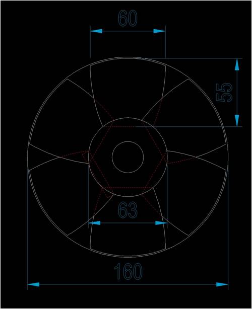

Woodsworks
Joined: 16/08/2010
Posts: 9
Posted: 08:15am 20 Aug 2010
Hi Anthony
That's a very kind offer, but the PVC profile is probably too large for what I have in mind.
Here's a screenshot of what I have drawn up:
The T-section I am hoping to get is 60x60x6mm.
Regards, Paul.
