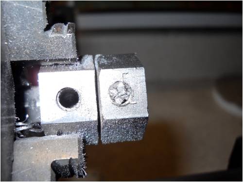

That little "flower" in the right-side hole is a broken 1/4-20 tap!
If it's any consolation, this is only the second time in my life I've broken off a tap. The first was when I was a kid, tapping a hole in aluminum (dry probably). This one was well lubricated and I used a #7 drill; everything was hunky-dory and then . . . . . snap!

You cant beat bad luck, the world is full of it. I have noticed that some of the cheaper taps around now are to hard and break very easily, if its not a real critical application I go one drill size larger to allow a bit of root clearance and just use your finger tips to turn the tap holder as its more sensitive as to pressure applied.

No, in all honesty, I played this one by the rules; correct tap drill, 90* start, even hand pressure -- the whole bit. This was one of my "trusted" taps by the way; one I've had for over 30 years. Maybe it was trying to tell me something, eh?
All joking aside, you can't go wrong buying quality tooling even though you have to pay top $. Even then, apparently, s**t happens!

Well Mac the picture looks to be a broken 4 flute tap?
4 fluters break the easiest!! fact!. The tap needs to be sharp age dosen't matter.
As Bob stated go one size larger in some of todays steels this is necessary.
If you were to look at the tap drill call out on Caterpillar's prints you'll see they call for the next bigger.
On some the standard tap drill call out will work but the hole will be loose or over size when you put your screw in. Then if you use the next size bigger it will give you a good hole.
Probably for you a self tapping screw would be best or Elmer's glue.''

I was using a starter tap and had drilled the hole deep enough to allow the tap to travel all the way through the opening. I used a #7 drill bit and at the time thought #6 might be easier, but I didn't want a sloppy fit, cause this was to be a set screw to hold a hub squarely on a shaft.
Sometimes, if it's really critical, I'll chase a first-cut thread with a bottoming tap just to make sure there are no burrs. I didn't make it that far this time!
