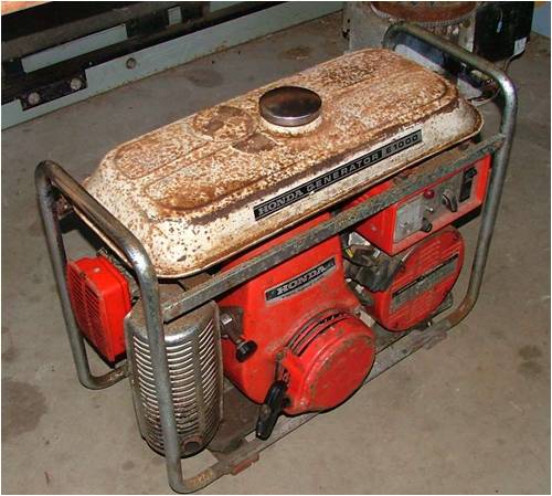

I was given a old ( 1970's ) Honda E1000E 1kw gen set the other day. It didn't run and had been sitting for many years. A fun little project, I like restoring old machinery, which is why I have 3 ride on lawn mowers!

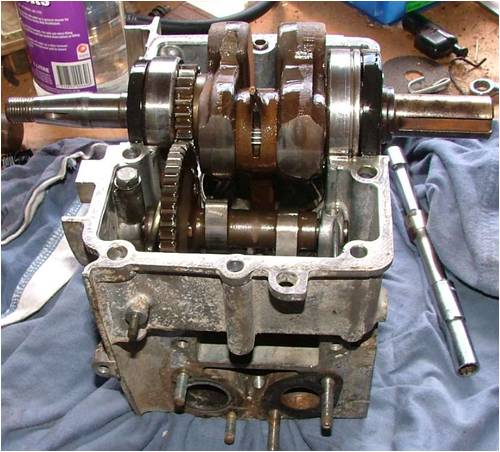

Pulled the motor bottem end apart. The crank bearings are a bit loose, as was the big end bearing. Piston compression rings ok, but oil ring stuck. I broke the oil ring trying to free it, so time to do some research and find some replacement parts.
The main bearings were easy to find. The big end bearing is made up of rollers on a pressed together crank, no way was I going to tackle that one, so I'll leave them in place and hopefully they will last. I found a supplied for the piston rings, $70 for the set, on order.

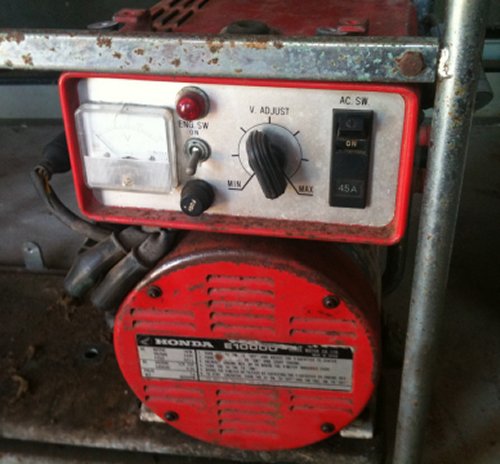

This is the alternator.

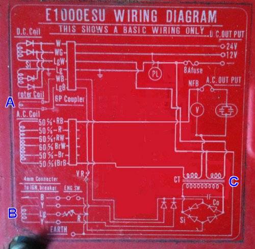

Circuit diagram, I edited it a bit to remove the voltage select plugs. A is the armature coil, B is the exciter coil in the little motor, C is the regulating transformer, its really very simple.

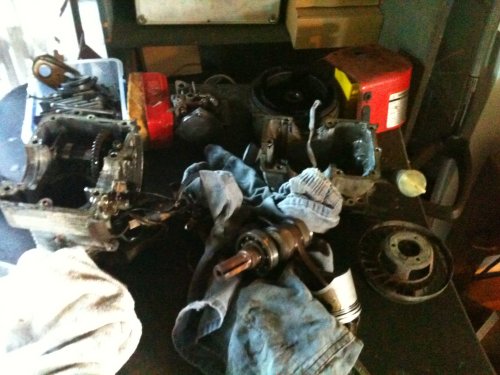

This is the motor in bits. Poor pic, camera phone.

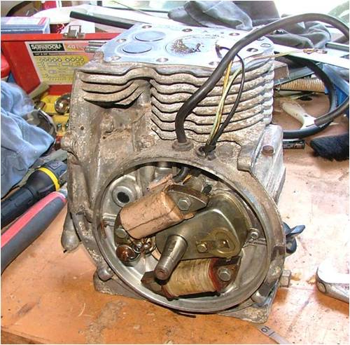

The ignition coil and exciter coil. Its a points magneto system.
