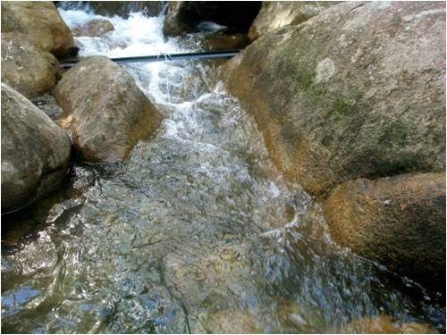

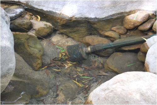

Over the last couple of years I have dealt with just your sort of dilema. I do have good quality take up screen at the inlet end that I have anchored with a star picket horazontally between 2 huge boulders in the middle of waterway. Attached to this is a short length of stainless steel cable. this sits in only a small pool in the middle of a turbulent creek. Air locks can become a problem but I have a purge line that after heavy rain I open up fully and any air,sand or derbris gets flushed out. Also the pipe is settled in amongst some rock and kept at least 6 inches below the surface..just upstream I manevoured a few rocks around to reduce the surface velocity thus reducing the bubbles getting down to the screen.
Now I know how hard it is to get 400 metres of gravity feed going again and for this I have a high pressure low volume 12 volt pump that I can run off a gen set or even a car battery. While this is refilling the poly pipe I head up and check the lines for air and either shake out or find the closest coupling and re purge from that point...just be sure that where the pipe leaves the creek needs to be temporar dropped to push out the air at the top end. after about 30 mins of priming generally there is enough (siphon" to get it running again.
Invest in a good quality screen for up the top as this will solve most of your problems as these can be fitted with the proper coupling directly to your polypipe and will hold via the steel cable and anchored star picket
