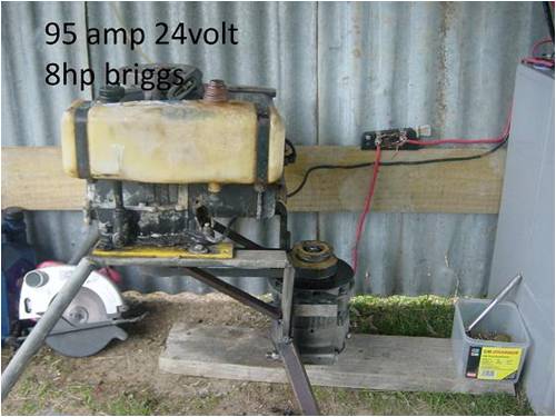

Hi i have one of these the alternator is a caterpillar 24 volt 95 amp it was on an old 8 hp briggs until it died of old age now its on a kola ten hp electric start motor and when my bank is down it needs all ten hp to run the alternator (works real hard) here is a picture of the old motor setup not tidy but it worked.

Posted: 01:51am 09 Mar 2011
Thanks for the idea here guys, much appreciated.
I decided to go with a 24v alternator + built in regulator for convenience.
My setup looks remarkably like yours Shawn, old B&S motor with alternator beside, will get a pic up soon I hope.
