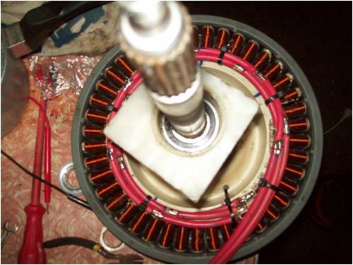

Posted: 09:03am 21 Mar 2011
Photo of first finished Star Configuration F&P generator.

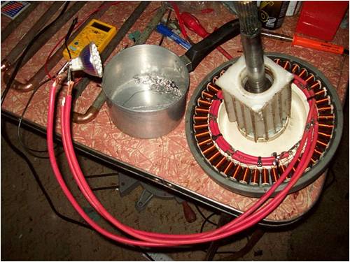

Posted: 01:00pm 21 Mar 2011
Just finished number two on midnight.
