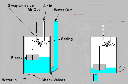

Here's a basic pic.
The whole thing is under water. A float slides up and down a push rod thats attached to a 2 way valve via its control lever. The push rod has two stops, one above and one below the float. The air valve has two positions, when down it lets air out of the chamber, so it fills with water. When up, it lets compressed air into the chamber, forcing the water out through the check valve.
The spring is to snap the valve from one position to the other, and thats the bit I'm wondering if is commerically available, or I need to make something.

I've been scribbling diagrams on bits of paper for the last day and I think I've come up with a pump that will work with one moving part. It should work in 300mm of water depth and pump as high and as quickly as the air pressure can force it. I'll see if I can build a prototype in the next couple of days.

If you should decide on the displacement technique using compressed air, there is a ball valve that's called an "Ortega Valve" which might be handy. Basically it's a "T" valve and the handle shuttles water either left or right of the tee.
To use it in your application, water could be let into the tank with the valve shifted to the left while at the same time a linkage uncorks an air vent. When the float signals the tank is full, the valve slides to the right letting in compressed air while another linkage opens the discharge port. One valve, two linkages, a 12-volt solenoid or two and a couple corks!
Just an idea.

Glen, could you use a valve and handle off the water tank side of a toilet? It would be quite simple to rig. The chamber fills with air, operates the handle and lift the valve. When the residual air reaches the valve, it closes and resets. Sorry.I'm not good at drawings.
