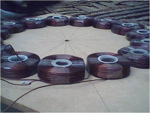

Here are some of the picture of the my work as you said. It will take me a little time to get acquainted with the forum tools and tips and tricks.
I believe that in forums like these every body is learning from everybody. So, no body is a student and teacher and every body is a teacher and student.
It is indeed honour for me to be here and to join the family of enthusiasts who build useful things for fun.

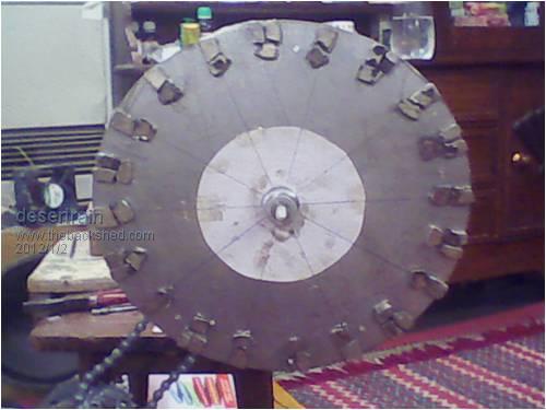

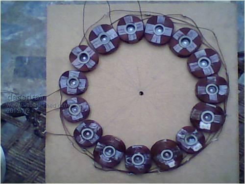

This is the old toy stater 15 coils, 110 turns per coil, 19 SWG (3 phase) Maximum voltage=30 volt.
Old toy rotor with solid hard drive magnets stacked on to each other.

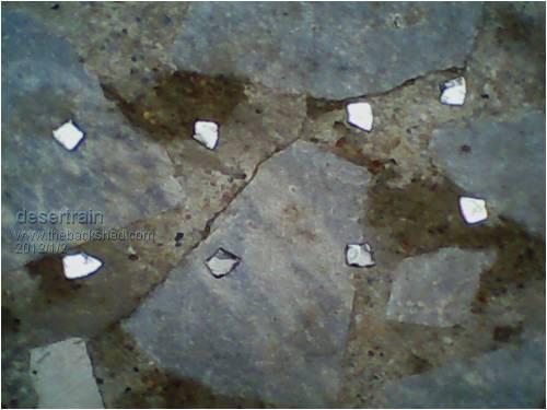

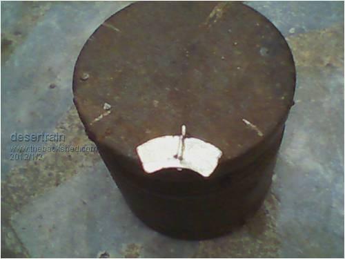

A Hard Drive Magnet
Broken Magnets.

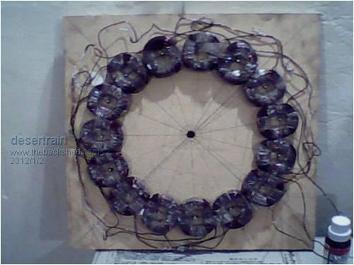

New Stator with 15 coils, 210 turns per coil, 18 SWG, (3Phase) Maximum voltage = 90 volt. (looking for 220)
Side view of coils on statur

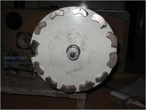

the new rotor with three set of broken magnets N - S - N - S situation
Please feel free to ask any question or query I would be more than happy to replay.

whether aluminum or copper those coils are beautifully formed.
very nice work.
is this a single magnet rotor? or a double magnet rotor?
