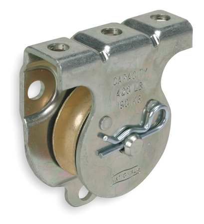

A rope sheave like this in 1/4" should only be a couple of $

  yahoo2 said   A rope sheave like this in 1/4" should only be a couple of $
Hey Yahoo, do you have a link to the makers or suppliers of this sheave .

  fillm said   do you have a link to the makers or suppliers of this sheave .
Sorry no, I can tell you it is made by National Mfg Co probably called a wall mount or ceiling mount pulley and usually it is a 3/8" width nickel sheave.
It SHOULD cost about $8 and the replacement sheave $1.50
other brands I have seen are battalion and campbell.
They are not generally sold by brand, every large chain store will have their own stock codes and they are lumped in with swivels, eye hooks and snap hooks (and usually out of stock ).
