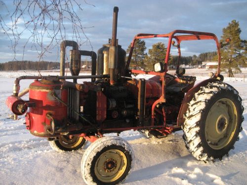

I have had my interest sparked by this little beauty.
It's a david brown tractor running on producer gas.
About now you are probably thinking the same as I did, ...you know..like..ummm..wot eva!
It was a originally a diesel
I didn't realise a diesel conversion was possible
Built by Johan Linell there is some details on his interesting website "Around Sweden with wood in the tank" listed under Wood gas tractor
Pretty sure the white stuff is icing sugar.

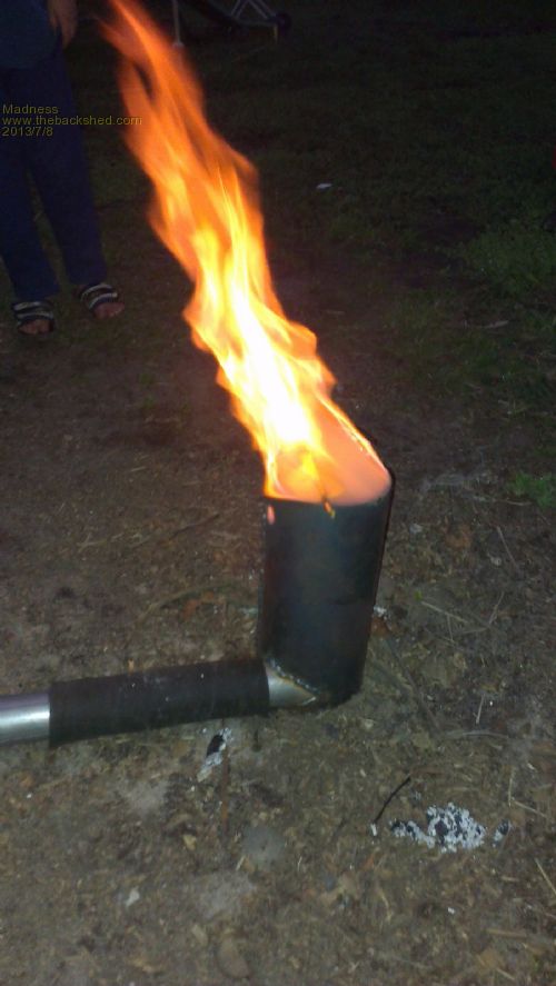

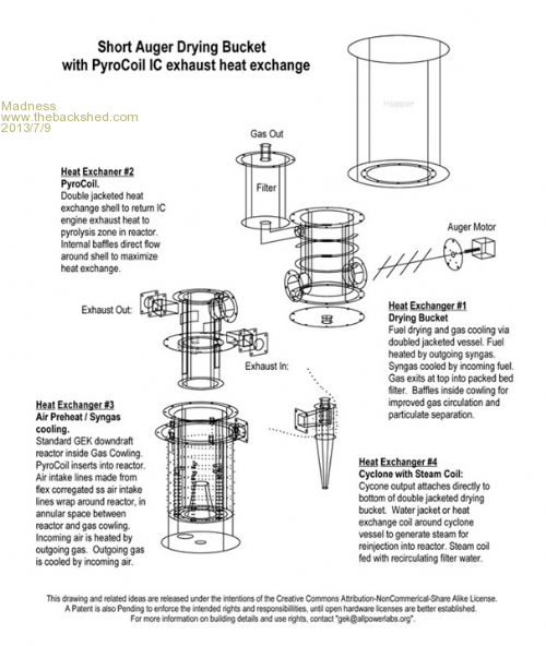

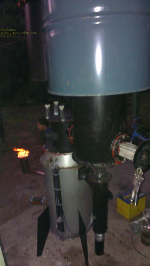

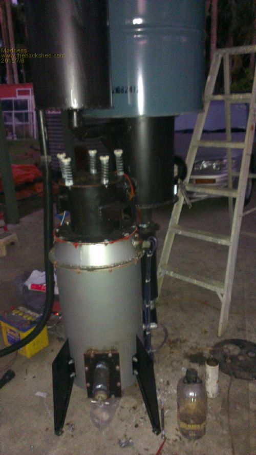

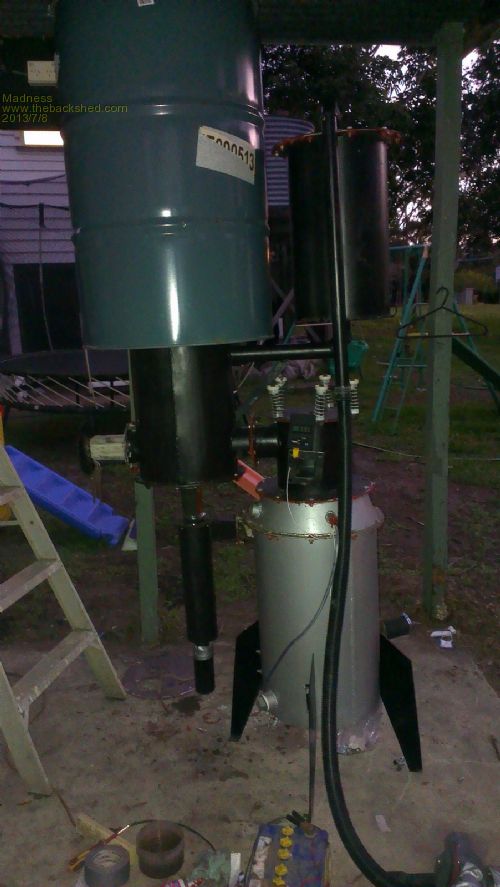

Posted: 12:23pm 08 Jul 2013

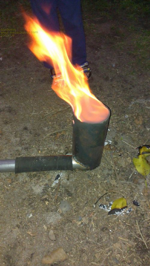

I have decided to go a different way with this project. I have built a Gasifier using the All Power Labs GEK design. You can download cad drawings and have all the parts cut on a CNC Plasma cutter as I have done. Although I had to make some modifications due to not being able to get the flexible gas lines they use for preheating the air.
I am connecting the gasifier to a 5 KW petrol marine generator that I picked up on Ebay for $105, it would not turn over. The generator has a 1240 CC Nissan engine that runs at 1500 RPM, the same engine is used on a 7.5 KW version of the same generator set, so I have extra capacity in the engine to allow for the power drop due to running on woodgas. Turned out water had got into the cylinders. a hone, new rings and head gasket fixed it.
All going well I will have the Generator running off the woodgas in the next few days. It should run for around 8 hours at full power off the 200 Litre drum full of chips.
