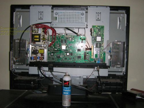

Yesterday being very hot it came out in more spots then a TV with chicken spots, it became almost not viewable, so again i removed the 22 zillion screws to access the power board, then armed myself with a can of component freeze, with intended to wait for the green graph chicken spots to show, then freeze each power cap to see if i could locate the problem.
Now this is why im sure its a female TV ( other than the odd need for a visit to rehab, or some personal time of fiddling with its moods and other bits)
I powered it up backless (back all exposed) and waited for the green chicken spots, and waited, and waited, and its been 2 days that have now passed without a glitch................Hmmm Bugger!!!!!
Im sure its female and just wanted a change ??? and it thinks going backless is the in way to go!!
All i can say sweet heart, is next time you throw a hissy fit im ready to freeze your bits. ( i bet she is reading this as i type ........ So be WARNED, precious!)

Posted: 05:45pm 25 Jan 2013
Just an update on "she"
Since armed with a can of nipple freeze spray handy, and the removal of the back covers, along with the pre warning of council trash should "it" have a hissy fit and malfunction again, for several weeks now "she" has not failed in any way, a pure faultless operation.
It might be time to start putting the clothes/covers back on her.

Posted: 10:41pm 25 Jan 2013
Hi Pete
While you leave the back off it will work OK due to better ventilation as soon as you put it back together same again, if you want to find whats wrong use your heat gun on each board to warm it up and then the freeze to find the faulty bit.
