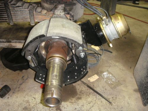

It is still pretty rare to see spring brakes on a trailer. Most of the ones I see are just the plain ol single diaphragm brakes. If the trailer air tank is empty the brakes are off.
If the red air supply hose is cut then a relay valve is triggered and the air pressure in the tank is used to apply the trailer brakes. It fools a lot of truckies because the trailer brakes are on as they start their truck in the morning and they have to wait for the pressure to get up before they will release.
spring brakes or double chamber, double diaphragm or maxi's are usually only on the drive axles on the prime mover.
The black chamber in this photo of a drive axle is the service brakes and the nickle plated chamber on the top is the chamber with the big spring in it. If you look closely there is a small bolt attached to the housing between the chambers, this is a manual release tool. If the diaphragm ruptures in the spring chamber then the bolt is fitted in the top and the spring is compressed by hand so the truck can be moved.
Posted: 02:46pm 11 Feb 2013
  Quote   this is a manual release tool. If the diaphragm ruptures in the spring chamber then the bolt is fitted in the top and the spring is compressed by hand so the truck can be moved.
Also very important to install the bolt when disassembling the Maxi for repairs or diaphragm replacement, or the spring will likely take your head off if not restrained when the retaining clamp is removed.Edited by Downwind 2013-02-13
