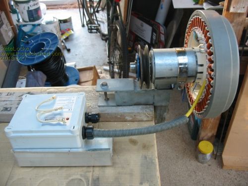

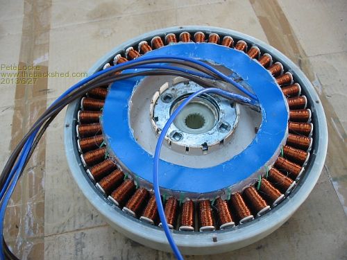

Howdy all. First post, so please bare with me and sorry if this subject has been covered, but I couldn't find what I was after in the search engine. So here goes. A mate of mine has a water wheel (good old steam boat paddle style)which turns at 20rpm, give or take. It sits in a stream but there is not a great fall, only plenty of volume. There is a belt drive step up of 5 to 1 giving a shaft speed of 100rpm on the F&P 80 series stator. He presented the unit to me with a stator that didn't work. Test showed a no load voltage of 5volts at 200rpm. Couldn't get in to it as it was well sealed...
Re wired an 80 series stator for 2x7c.
This produces 36vdc at 100rpm unloaded. 150rpm will produce 28volts at 1amp at the output of the SunSaver10L controller. That's all he's after for his 24volt setup. My questions are what RPM is typically aimed at for a 2X7C to look after a 24volt system, and is the SS10L suitable for the F&P generator?
