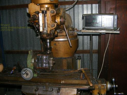

Anyway heres a pic from when I was roughing out the flats on the crankcase.
Next time I'm working on it I'll take some more pic's of the gear I've made and my next bit of research is trying to find some 60mm pistons that a car engine uses so spares can be easily sourced.

That's a nice looking mill there Bryan.
