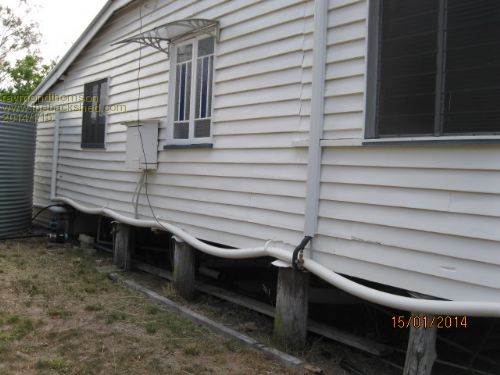

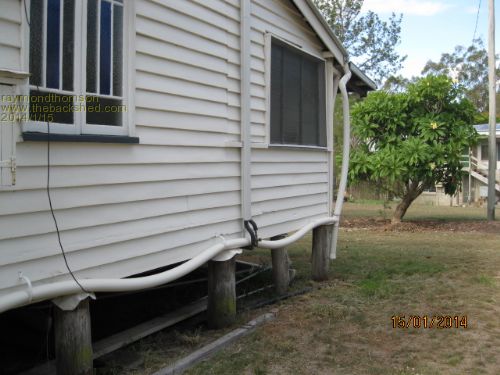

Just back from freezing in Europe I was a bit surprised just how hot it can get here when I saw the storm pipes on the old cottage. Looks as if the water in the pipe hadn't drained out, (dirty filter), and then 'boiled' causing the pipe to buckle. Unfortunately the pipe has to go this way to avoid the windows.
Just another little job for the DO List, happy days.

Wow, that's a interesting photo. I don't know what temperature PVC gets soft at, but looks like the heatwave heat and weight of the water was enough to deform it.
I wonder how many other people suffered the same problem.
Nice frangipani in the back yard too.

Looking at that, your floor stumps are say 2.5m to 3m apart and your PVC supports are further apart probably 4m. Horizontal stormwater PVC needs a wee more support (read) every m at least. I`d sack your plumber.

Yea personally with all storm water pipes I put underground so mishaps can't happen, when we bought the farm the pipes were above ground and one guessed it the son playing around broke a pipe and water flooded everywhere. To top it all off it was winter and it rained solid for the next week so we basically had a moat around the house. Bought all new pipe and put the lot underground and aint had a problem since (touch wood).

When I was looking at putting the down pipes on my house, my brother suggested I run them under the house. At the time I thought that was weird, as the tank inlet was almost level with the house floor ( high set house ), and it would be difficult to get all the pipes flowing down hill. He said that's how they do it now, and the pipes remain wet, full of water. Personally, I didn't like the idea, it mean screens on the gutters and a lot more work to keep clean. So I ended up running the pipes along the outside walls and down hill all the way to the tank. That way they remain dry.
It also means, looking at Raymonds situation, I wont have to worry about heat waves deforming my down pipes.
If I were you Raymond, I would extend the pipes and put them underground.

I am with Bryan1 on this one. Underground pipes will never get purged. My Tee piece has a drain at the bottom with a 1.25mm hole so that if there is extended dry the holding water will all drain away, but in periods of intermittent rain the large volume of water is not wasted. My mistake this time was too much travelling (!) and forgetting to clean out the filter so it didn't drain. I will also admit to needing a few more support brackets but it was always a temporary place to live while building the new house, well that's my excuse.
