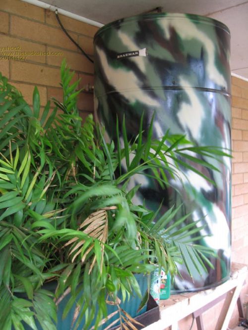

Mine was installed in 1963.
Took it to pieces sometime in the eighties and soldered a seam that had split and while we had it apart I filled the cavity with batt insulation. There is a lot of room in the old ones.
Apart from some mice pulling the glass out it has been a trouble free upgrade.

I can only guess you got your 60's and 90's mixed up, because it dont look to be a 60's model to me.
63 makes it as old as myself, and i doubt that is its correct date.
As you say a solder repair, would deem it a low pressure unit, and not a mains pressure system, as here i often see above 80psi supply and would doubt a copper soldered cylinder would withstand that pressure.
Nice paint job all the same.

Those had a heat exchange coil, the outer cylinder was not exposed to mains pressure. That`s if I`m seeing right. I`d reckon there`d be probably still a few around here from that era operating, Braemars & Saxons installed by the hundreds when the "grid hit town". The local would call the plumber and in broken English, ask to have the "hot sister" installed.

Yeah Pete it is gravity fed low pressure, I have never had mains water. It pre-dates the mains power here by 7 years. I have been tempted to hook the old wetback lines up to a solar system a number of times but the amount of hot water I use doesn't justify the cost (or effort, I'm lazy). I should insulate some of the exposed pipework around the tank I suppose.
I had a problem with the thermostat a while back and the plumber would not even look for a replacement (too old) so I gritted the teeth and went looking myself. Turns out, it is a standard industrial fitment and very cheap. That was a win!
I purchased a roll of very heavy bubble wrap to transport some vintage TV's and radiograms a few years ago, the bubbles were about 20mm wide and thick plastic. I thought that might last a bit longer than the thinner stuff as insulation before it broke down, sadly no. I assume it is the UV that causes it, I got about 9 winters from some window inserts I made to winterize the house and keep some extra heat in, before they crumbled.
It is a great idea Pete, perhaps an outer skin of corroflute and some of that plastic banding would give a heater a slick looking finish. I would not recommend the camouflage paintjob without practicing on something else first, this took me about six attempts and a lot of paint.
