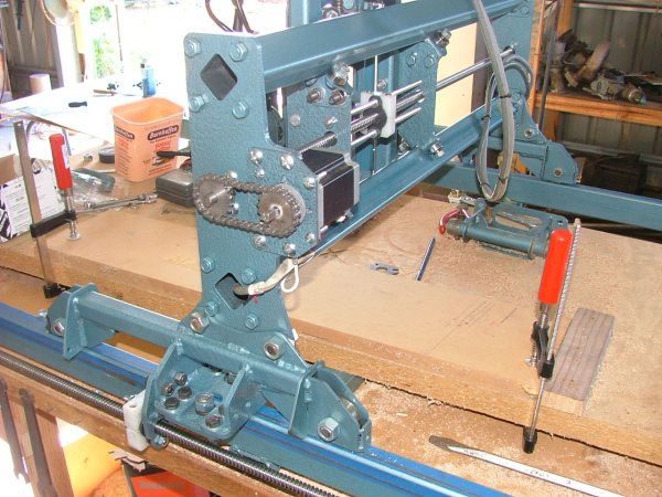

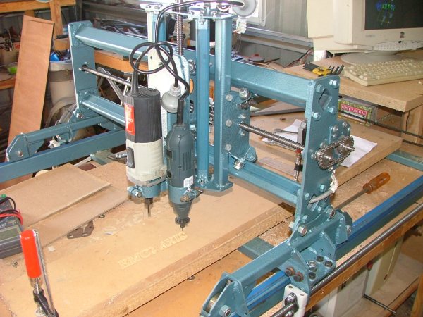

Hi all.
Spent the last couple of weeks working on a new CNC router design. This is a total revamp of my old router design, learned a lot from the mistakes in that machine and the new one is much stronger, has less parts and is easier to assemble and adjust. What I'm doing is putting together a CNC kit, made from laser cut parts. The kit is designed to be scalable, so you could build, for example, a 2400*1200 ( 8 by 4 foot ) cnc router, or a 3000*1500 cnc plasma cutter. The design uses common RHS box section as the linear bearing rails, not perfect but for timber routing or plasma cutting more than good enough, and very cheap. The design allows easy adjustment to remove any backlash or wear in the rails, and rails are easily replaced with new lengths of box section. For drive you can use either common all-thread, or acme thread for better speed.
Software wise I'm trialing EMC2 ( Thanks Vasi for the link ). Its a free linux ( Ubuntu ) cnc software package that does run very well compared to the windows based systems I've tried in the past. I'm struggling with the Linux platform a bit, I found a nice Linux based CAD package, but it needs to be compiled before it runs, and this comes up with errors I dont understand at this stage, but I'll get there. The Ubuntu version of Linux is very nice.

Hi Glenn, very nice router, I like y axis (linear bearings solution).

This was the first prototype cnc table to prove the linear bearings and laser cut parts all fit together correctly. It worked, though I need to make a few slight changes to a couple of parts, things like this bolt was difficult to get in that hole because that bit was in the way, sort of stuff. My mate and I will be building the next one, with the changes needed, in the next couple of weeks. Looks like we will go for a work area of 2400*1200mm ( mine was only 1000*500 ), and will take a router head and a plasma head, he has a hand held plasma cutter.
Once that 2nd prototype is complete, we will build the first production model, assemble it taking photos along the way and write up the construction manual. Then we will look at getting a few of these machines out there at near cost price, mainly to get some feedback on how they went together and any problems. So I'll let everyone know about it when we are ready for that stage, sort of a special offer to members of TheBackShed.
There are a couple of software options. Windows based KCam or Mach2 are good for general router use. The Linux based EMC2 is better for more serious machines, plasma cutters, etc. EMC comes with something call HAL, which is used to create interfaces between the software, screen and hardware, ie you could use the HAL layer to display a plasma current control on the computer screen.
Costs are not known yet, but the laser cut parts we will supply will be the cheap part of most builds. On my router I have 3 microsteppers worth about $330, 3 steppers at $450, a Pentium 2.4 Gig PC, Power supply, misc parts, so you could spend over $1000 just for the electronics and motors. I did start small with steppers from printers and single step controllers, but soon found you cant beat a microstepper and BIG stepper motor. We are looking at supplying from just the laser cut parts to complete machines. The main goal of these machines was to use cheap easily replaced parts, ie its all SHS ( box section ), and common bearings. A single linear bearing for a commercial router/plasma/laser can cost over $1000 per meter, where you could build a whole machine for that much money if you are willing to occasionally adjust out any blacklash or replace a length of box section.

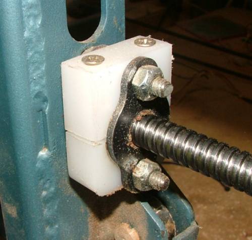

The Acme thread I used was from United Fasteners. 1/2 inch diameter, 6 turns per inch, came in 12 foot lengths, and I think I paid about $70 per length, very cheap. I also ordered one nut to suit. Well it looked like it was machined in a hobby lathe, very sloppy, so I used it on the Z axis where gravity will take out the backlash. When you order the acme thread make sure they pack it on a lenght of timber, one length I ordered wasn't and arived bent like a banana.
For nuts I used a pieces of HDPE ( HDPE or Nylon can be bought cheap as kitchen cutting boards, the thick 10 or 12mm ones. Has a waxy feel to it. ). They were split and then melted onto a heated length of thread, cleaned up and drilled to take adjustment screws, these adjust the slop out of the nut. I'll go into the exact details on how they are made later, but the result is a smooth running HDPE nut with no backlash. Easy to make and replace, keeps with the plan of a machine with easily replaced wear parts.
For bearings on this model I'm using common skate wheel bearings.
