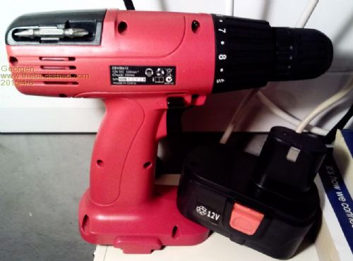

This my K-Mart drill with replacement battery.
Not sure if I threw out pieces of opened original battery, but doesn't matter.
If this one dies, I am going to get 10 NiMh batteries and make replacement battery.
Actually I thought about 18V cordless drill and to charge it directly from my 40W solar panels, but got this cheap 12V one.
