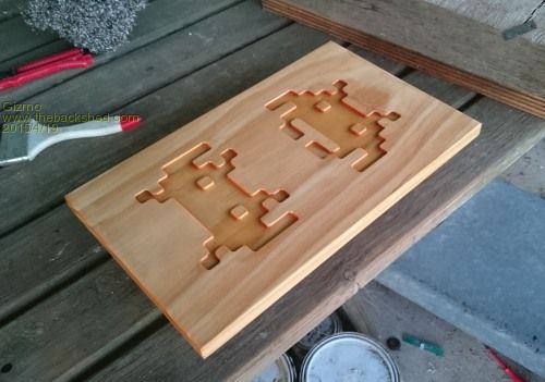

Only those of a certain age would quickly recognise the two characters. CNC'd from a piece of 230mm wide pine, sanded and varnished. The cut is 4mm deep, made in two 2mm passes, I find the router has trouble cutting anything deeper. One tip I learnt, if applying thick coats of varnish, allow a couple of day to dry between coats or the varnish will wrinkle.
There is a recess at the back to hang on a nail.

Looks great.
Probably somebody with 3D printer could make something like that from plastic.
Ach the possibilities :)
George
Posted: 03:31am 20 Apr 2015
Think i remember playing a game in my early teens with on screen charactors that look like that, one of the first computer games i would think.
Pete.

Now I do feel old. I was past it when PacMan came out. Did my time on Space Invaders Nice work though.

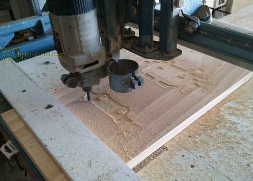

On picture it looks that some kind of dust removal would be good idea, as dust can be seen half way up the motor.

Yeah a dust removal system is on the to do list. I want something thats not going to draw a 1000 watts and make too much noise, so that rules out the workshop vac.

Here is a vac if you have a air compressor. They work very well. Excellent for sucking dirt out of tires ect
2ND idea use a 100mm fan to blow through a venturi and suck the dust from an elbow in the centre. eg old carburetor or steam injector principle
Have a 2" plastic guard around router and suction that. bring hose off at angle to compliment the direction of router.
Washing machine pump out hose very flexible. 3/4 to 1" dia.
set up below bench, gravity help dust down. only need stocking/panty hose over top of dust bucket. Blow in from side of bucket to create a clockwise whirly wind, help separate dust
vacuum at dentist created by water through venturi.
lets not think how much water down the drain. (I have a unit somewhere in the back shed)

Now you all have had fun imagineering, get a rechargeable "dust buster" !
I thought of this first but then it would be fun to spend hours making something.
